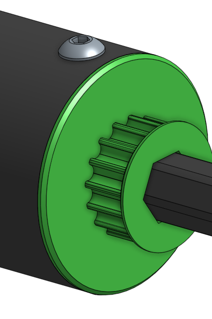

For deadaxle rollers, you have a few options. 1678 and 254 have some pretty good rollers that work well, i personally prefer the one at parts.frccad.com made by @AndrewCard :pray:
You just have to print 2 endcaps, and use standard 1/2 or 3/8 hex with the associated bearings. You can mount them through the tapped hole in the axle. The benefit of a deadaxle means it can double as a standoff between plates.
You can also use PVC pipe as the roller, but you would have to adjust the cap to accommodate the different ID.

Any chance we could allow the pullies to go to smaller tooth counts? They are currently limited at 24 as the minimum.
I believe it is set to that to ensure you can fit a standard 1.125OD 1/2in hex bearing, as any smaller either breaks it or leaves so little material around the bearing that it becomes really sketchy.

But in live axle setups without the bearing in the rollers you can go much smaller. My take on most of these configurable assemblies is keep the options wider, which puts the onus on the user a bit more to prevent breaking stuff. To each their own though.
That’s fair, a big driving point behind Andrew’s development it looked like was to make it so it could not break.
Ive changed it to go down to 16 which is the smallest size that the mkcad configurable htd pulley works for
