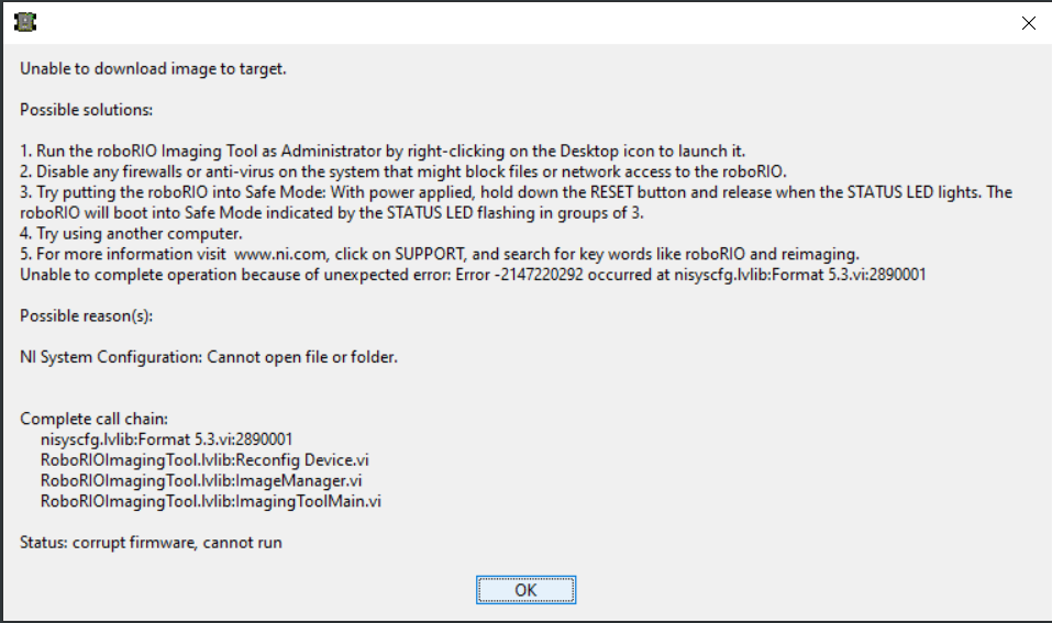

I then thought I would try to re-image the RoboRIO. I fired up the RoboRIO imaging tool, and it could not detect the RIO when connected with the USB cable, even when running the tool as administrator. I disabled my WiFi and turned off all firewall settings, and still couldn’t see it. I deleted and re-installed the latest 2023 FRC Game Tools from NI, and then I was able to see the RIO, but only while the RIO was restarted in safe mode. When trying to reformat with the latest image, I was met with this error.

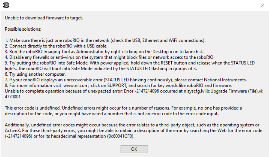

When trying to update the firmware of the RIO, I was met with yet another error.

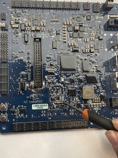

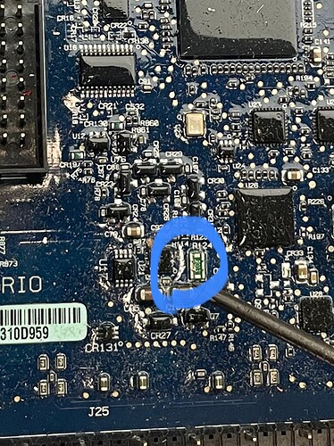

Last week I had the very exact problem, al the leds on the rio were good as well and everything looked all right, then we open the rio to see if there was anything inside and we found this:
IMG_1080 Small
Turns out we had some kind of rubbish inside the rio, we tried removing it but it didn’t worked right away, and then after the weekend fortunately it worked again.
Maybe your team scuttle something near the rio and some trash got inside of it. You should try opening and check if there’s something there.
Hope this helps and good luck with the rio
I would advice against opening the rio, at least until NI say what they have to say
Opening your Rio to clean out swarf is perfectly fine, as long as you’re careful.
You may indeed have a failed chip … Even so I am yet to a see a failed Rio anywhere in our robots, and some of ours are from 2015.
It will not void your warranty. :slight_smile: Swarf in the Rio is one of the most common failure modes. They are remarkably reliable.

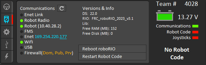

What does the DS show for disk space usage? That error can sometimes show up if there is no disk space, which can also cause imaging failures.
Sorry for the delay, we had some time off between meetings. I followed NI’s advice and tried using last year’s (2022) version of the NI game tools with the same errors. Checking Driver Station shows that there is 0 MB of disk space available on the RIO, but I’m not sure how to remediate that problem since SSH/FTP are not working either.
SSH isn’t working? Thats odd, it shouldn’t be requiring disk space. What error is it giving? Make sure you’re usb connected when trying.
