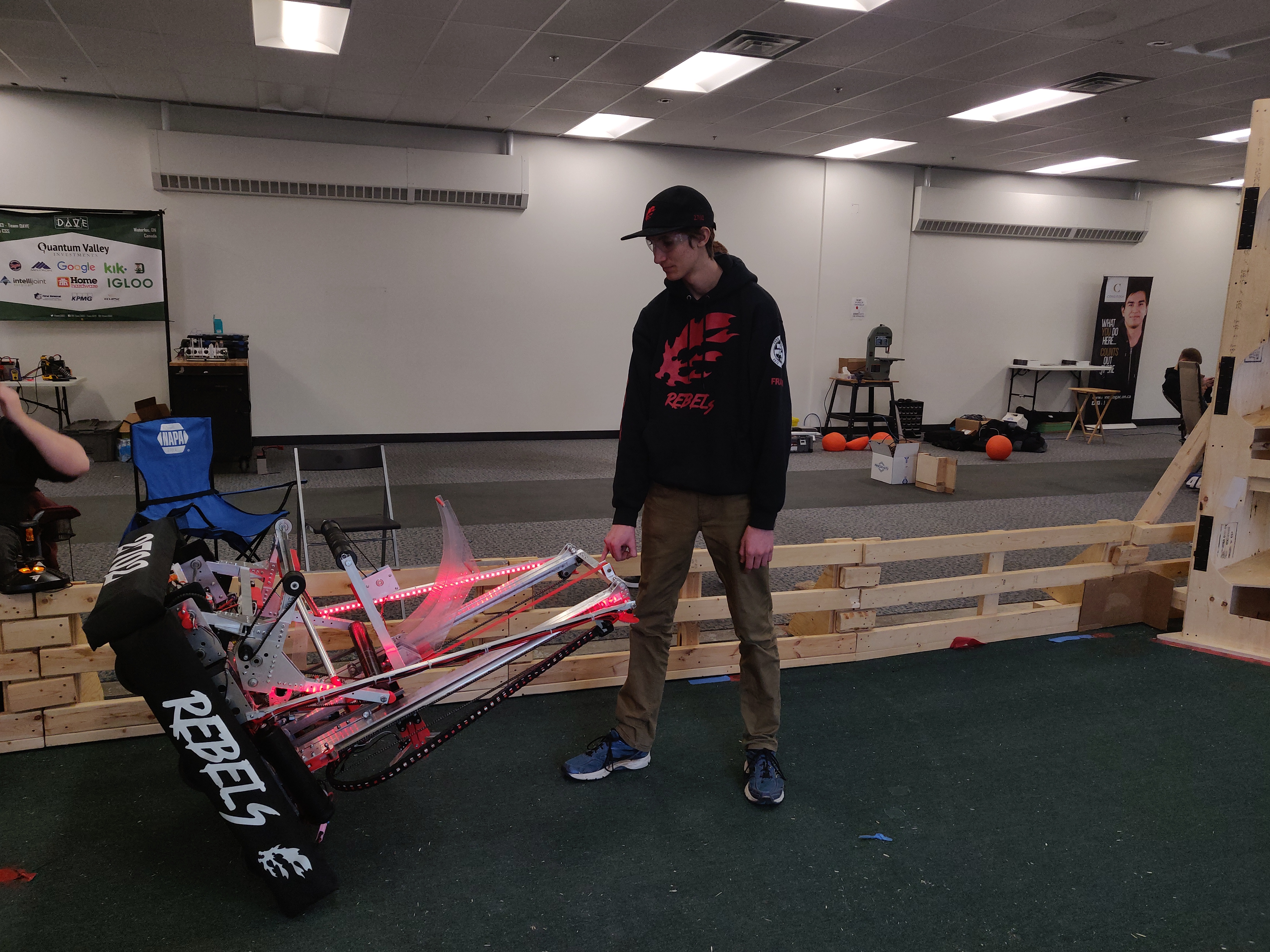

Not a “high-ranked” robot, but here’s our max weight robot at it’s “balance point”.
Aside from optimized gearing, don’t forget to take into account the actual robot size, bumper material, and bumper shape WRT being able to evade defense.
Hey FOPC pit neighbor! Our robot had a very similar balance point. Very annoying when you’re actually trying to tip it over to work on the underside :laughing:

Sweet COG, is it same fore and aft?

Yup. Our COG sits dead center just above the middle wheels on this robot with the intake folded in.
(When the intake is folded out it can’t tip forwards and it’s even harder to tip backwards.)
