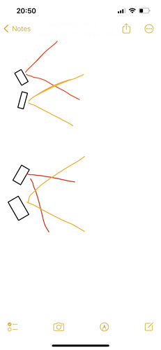

I’m planning to set two limelights in the front of our robot to track AprilTags next season.
I will set the lowest vertical field parallel the ground to ensure that I have the highest rate to see the apriltag.
About X axis field, I have thought two options now, but I am not sure which one is better.
Is there anyone can give me some suggestions?
I’d wait until you see the game, field layout, and pick some of the robot design.
The overall goal should be to maximize the number of tags seen by both cameras while your robot is doing high-precision motion.

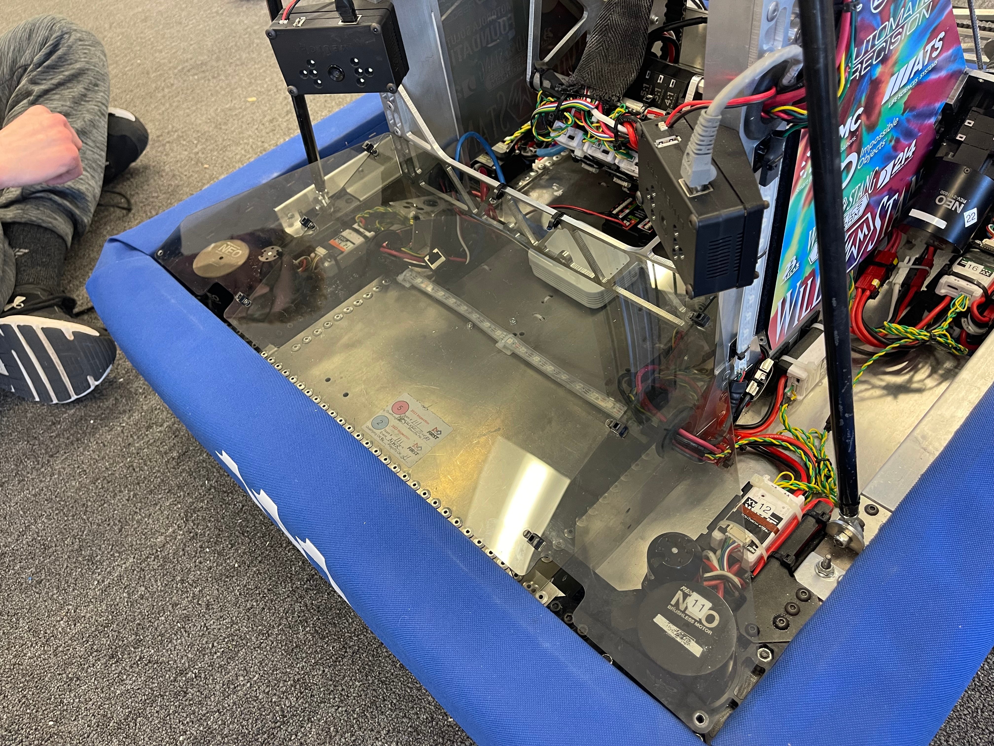

In 2023, most of this motion was while picking up or placing gamepieces. In these cases, there really were only one or two tags nearby, so a common strategy was to be “cross-eyed” - assume you have one tag you’re trying to localize off of, and point both cameras to see that one tag, just from different angles.
On the other hand, if there are a lot more tags this year, or if those tags aren’t right next to the pickup/drop-off locations where high precision is needed, a more “chameleon” technique of having the cameras observe different tags to increase information is useful.
For the 2023 game, the position of the various scoring positions versus the position of the AprilTag tended to favor the “cross-eye” arrangment:
But it all depends on what the field looks like and where, on the robot, you can mount the cameras to have an unobstructed view of the AprilTags in each of the relevant scoring locations.
