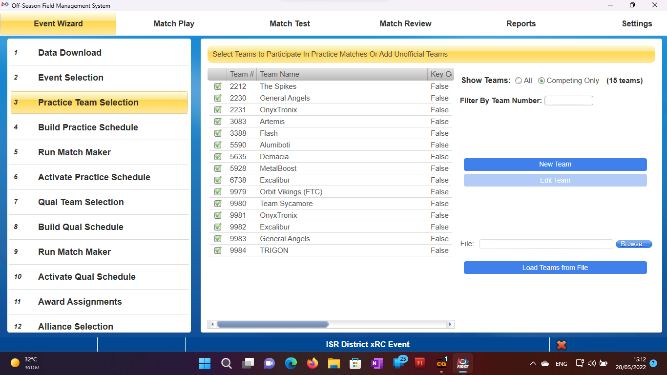

Can you show what your screen looks like?
This is my screen
Off-season FMS doesn’t have key generation because it is set up for use with a “normal” router. You should configure your router with a key for the event and configure all radios for home use (bridge) with the same key.
See the networking sections of the off-season FMS documentation for more info. Off-Season FMS | FMS Documentation
I’ve did it just like in the tutorial and still dont have a Generate Keys…
As I said, the off-season FMS does not have the generate keys functionality. You will not find the option because it does not exist (it is in the FMS used during the season with official fields, but it is removed from the off-season version).

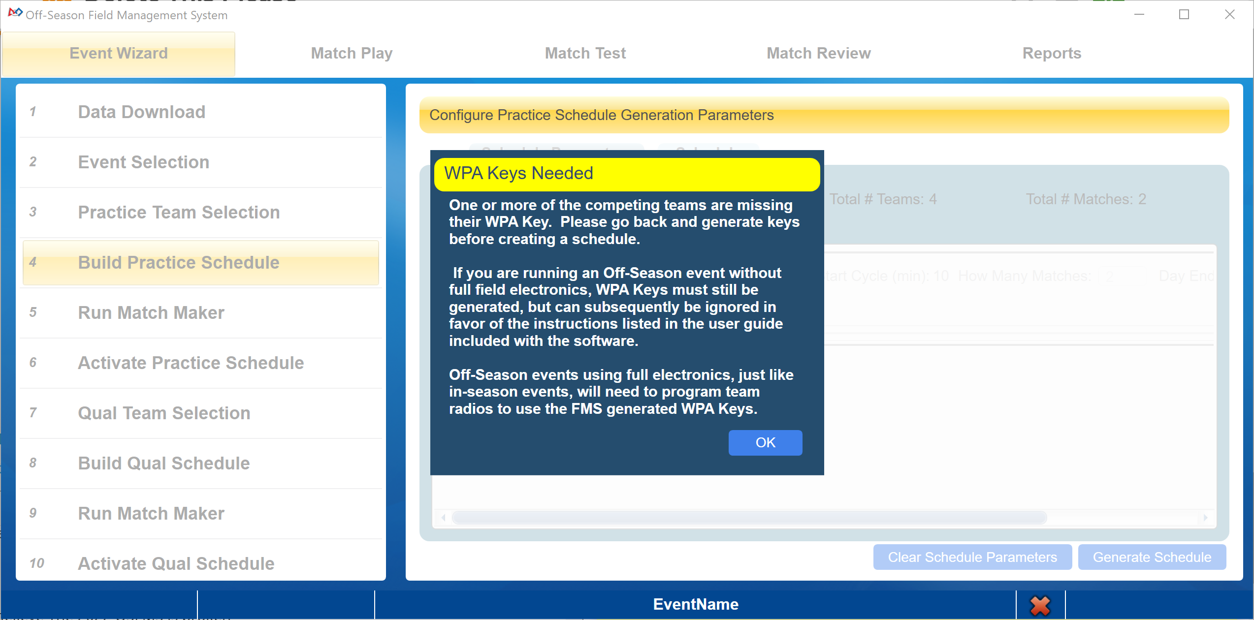

OK so the issue is with the Offseason FMS, I believe that when FIRST releases the FMS they cut features however they have cut the wrong feature in the 2022 OSFMS and have made it unusable
While it is true that
“Even though team WPA keys are not used”
the documentation still asks you to
“click Generate Security Keys before leaving this step (Match Play will require keys to exist in the database)”
(from the offseason FMS documentation)

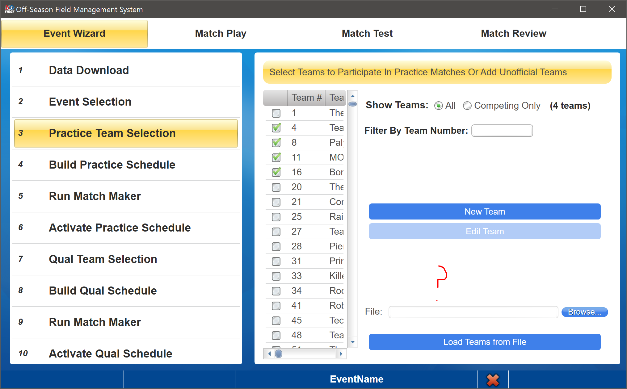

In the 2019 OSFMS, the generate keys button exists and is a required step in creating an offseason event,
Image 1
In the 2022 OSFMS the generate button after selecting teams for a new comp just doesn’t exist And when you move on to the next step it blocks you and asks you to generate the keys,
Image 2
Image 3
TLDR; I believe The 2022 OSFMS is broken @arnon001
