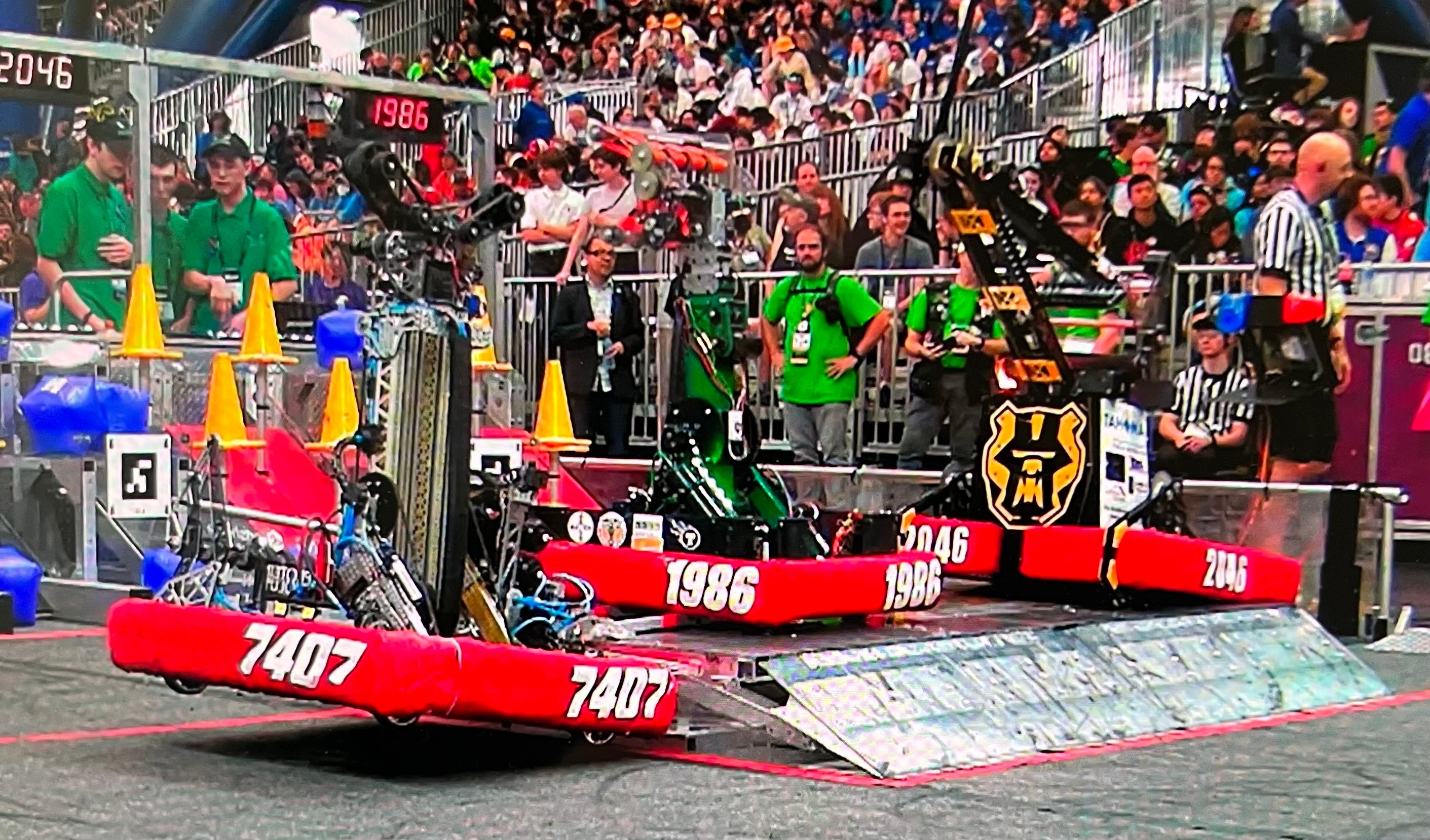

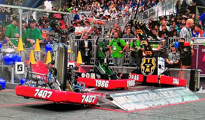

Speaking of this alliance, does anyone have good photos/videos of 2046 and 7407 side-climbing around 1986? The official match video doesn’t show a great view.

Here’s a photo I was able to capture. It was really fun to watch this happen in our four matches as an alliance, and I believe it was the only “double silly climb” alliance all year!

Ditto this was awesome to see and the whole reason we designed a crawler over forks.
Responding to OP, we felt out side crawler was slower than a well coordinated traditional climb, so we pulled it late Friday for more ballast.
