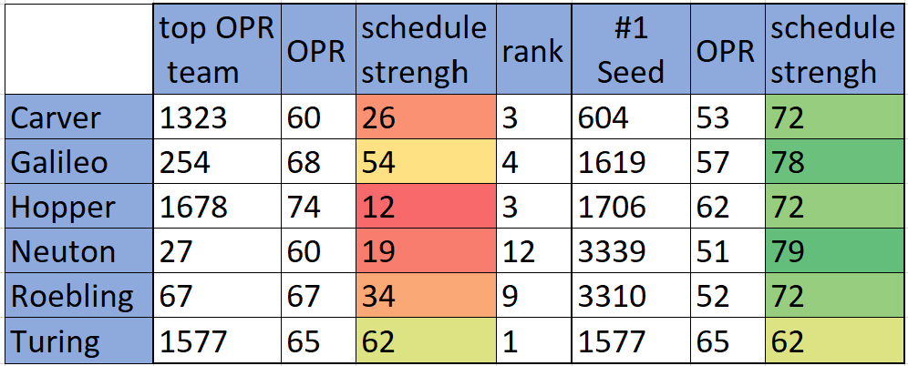

In this post (2022 Championship Match Schedules - #13 by Caleb_Sykes), Caleb Sykes did a great work analyzing the “schedule strength” (the likelihood that the given team will seed higher with this schedule than they would have with a random schedule.)
what struck me was the HUGE effect of the schedule on ranking this year (see table below)
Of course, all the winning teams did a great job! , they would not be there without building a great robot, driving it smoothly, using creative strategies, etc… nothing here comes to disrespect the great achievement/performance of all winning teams.
And still… seeing this table raised a concern -
All number one seeds had a schedule strength higher than 70 except for 1577, which also had a “positive” schedule of 62. (any number above 50 means that your schedule was favorable)
All top OPR robots (robots with the highest OPR) in all divisions that had a schedule strength below 60 are not #1 seed.
These two facts imply that:
  1. A high schedule strength was essential for finishing quals in the first place.
  2. No matter what was your OPR / performance - if your schedule strength was below 60 then you did not finish first place.
The implication of this is that this year - the schedule had a significantly higher effect on rankings than the teams’ performance.

for me this just highlights the need for good scouting on a team. At the championship level what pick you are doesnt matter as much as who your alliance is. None of these team didn’t have a chance to compete on eineinstien or at least a final in their division (could be wrong here). so in that way I think it’s perfectly fair. at lower levels is where I saw it make a much bigger difference. especially for bubble teams. I’ve always liked the design strategy of 3 rp is easy the 4th you need 2 high quality robots to achieve. Just wish that values would adjust with the level of play going on. Maybe have it tiered for weeks 1-5, districts and finally champs.
Yep, I ran the numbers with 30 cargo RP and it wasn’t a dramatic change. I actually ran all numbers between 15-40, and none of them did particularly well at sorting the teams by OPR (27-40 were in the same ballpark), which surprised me.
I came to the conclusion that there really wasn’t much you could do at champs to make schedules not matter as much. The simple fact that you were playing only 10 games in a 75 team field, and this field is historically the strongest field ever, just means that even the best teams will lose games.

Since it’s not made clear in the post… where does the OPR number come from? Is that the team’s pre-champs OPR? Is it a full season (including champs) OPR? Is it the OPR just from the champs qualifying matches?
Because that really matters. It ultimately doesn’t matter how high a team’s OPR is before champs. Things change. Maybe their driver is home sick so someone new is driving the robot. Maybe something broke on the robot in their first match and the fix isn’t working as well as they want it to. On the other side, maybe a team with a lower OPR made a positive change and is doing better at champs. Whatever the reason, no matter what the schedule is, a teams performance at champs may not be the same as their performance earlier in the season, and that could throw off numbers like these - especially when you’re talking about 450 teams!
I’d love to see a graph that shows a team’s champs qualifying round OPR against their qualifying round rank. Such a graph could really help show the overall trend for that specific event.

yes - CMP quals OPR - in order to check the performance in the CMP itself and not historic OPRs
There is also the fact that OPR is by no means a precise science that you can use to make claims about which robot was best.
I felt this game did a FAIRLY good job at ranking but luck in schedule definitely played a huge role. I found that this year that is was very difficult for a single robot to CARRY an alliance by themselves. Two pretty good robots would often beat one very good robot. Also if you happen to partner with two robots that both couldn’t climb OR score it made both of the bonus ranking points very difficult to impossible.
True, but neither is championship seeding. I believe that the OP is positing that there is a stronger correlation between OPR and robot quality than there is between Championship seeding and robot quality.
For what it’s worth, our mean score data looked like this for Turing’s top 8… this also has some flaws, but I think it’s interesting:
