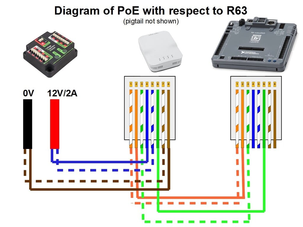

Another alternative is to use POE to power the radio rather than the barrel connector.
e.g., https://www.chiefdelphi.com/forums/a…7&d=1484316250

If you use something like this then
the POE plugs into the radio port closest to the barrel connector.
The other end connects to the roboRIO Ethernet port, while the separate power connections get cut to bare wires which go to the VRM where the radio barrel connector is already drawing power from.
That port accepts the 12-24v input power and it’s also to one you want the roboRIO to be connected to.
Don’t use the 802.3af port-it’s setup to expect 48v over POE which we don’t support on our FRC robots.

Using Poe, is excellent advice. One additional thought is to also run power to the barrel connector in parallel. Connect both the Poe power, and the barrel connector power, to the VRM. This is a legal configuration and has worked extremely well for us this past year.
Is that POE injector FRC legal for the 2017 system? If it is we will be ordering one ASAP haha.
We won’t know about the 2018 rules until kickoff, but that passive POE injector was legal this past season.
For those that want the rule, it’s covered in the blue box under R51 for the 2017 rules:
Note that this prohibits using any active POE Injector device to power the radio, but does not prohibit using any PASSIVE CONDUCTORS to inject the VRM power into an Ethernet cable plugged into the radio port labeled “18-24v POE”

The rules allowed that last year:
R63. The roboRIO Ethernet port must be connected to the Wireless Bridge port labeled “18-24 vPOE,” closest to the power connector (either directly, via a switch, or via a CAT5 Ethernet pigtail).
Note: Placing a switch between the roboRIO and radio may impede the ability for FIELD STAFF to troubleshoot roboRIO connection issues on the FIELD. Teams may be asked to try directly connecting from the radio to roboRIO as part of troubleshooting efforts.
