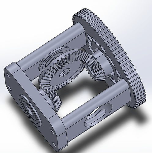

So as a fun cad challenge to myself I decided to create a differential gear box, modeled after the Lego version, using FRC parts. (I’m not that good at cad currently, but practicing to get better).
Obviously this isn’t something that feasible to use on an FRC robot though.
However I had an issue and I have no idea what the proper mesh distances are for bevel gears. Any help with that would be appreciated.
I’m currently using the 40 tooth bevel gears from andymark (am-2620) and the main drive gear is the Vexpro 72T 20DP Aluminum Spur Gear.
Bevel gear mesh distances are specific to the gear set, and bevel gears can typically only be mated with one other specific gear. The bevel gear you’re using can only be mated with andymark’s 20 tooth bevel gear (am-2621) (or another bevel of same module and tooth count) – it cannot mate with itself, as you have. To see the mounting distances for this bevel gear set, look at the layout prints for both gears in the set.

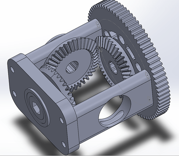

Updated using Andymark’s 20 tooth bevel gear to make the meshing work.
All in all, not to bad.
Just had to create a hex cutout in the 20 tooth gears as they originally use a 8mm round bore with a 2mm keyway

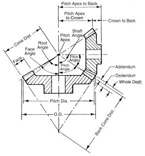

One easier trick for bevel gears: If you extend a line from the crowns (or roots) of the gear teeth, they’ll all meet in a single point called the “Apex”. The Apexes of two meshing bevel gears must be coincident. See below:
So in your 3D cad program, you can draw a sketch on the midplane of each of your gears to find the apex point. Then in the assembly, mate the two apex points together. Then measure to see how far off the rest of the assembly is :slight_smile:

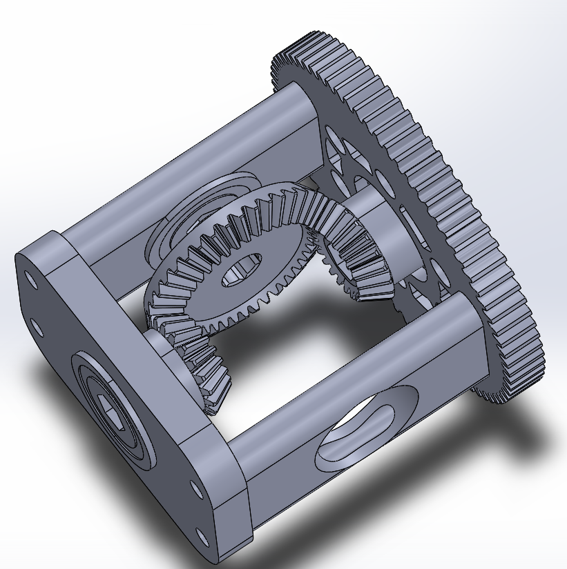

Just to note: your differential has a 2:1 increase, assuming you’re driving it from the 40 tooth gear and running wheels off the 20 tooth bevel gears. This is usually counterproductive, as motors usually spin faster and with lower torque than the application requires (long range flywheel shooters being a notable exception). You may want to consider at least an option to drive from the small crown gear, which doesn’t look too difficult given your general layout…
Oh, yeah. Reading this (and it seems pretty obvious now, otherwise teeth would interfere on the inner edge and gap on the outer edge), that means that the angle along the crowns will be slightly larger than that along the roots. The real bevel angle is the angle of the pitch cone, roughly half way in between.
Actually not. The entire housing is rotating with the outer gear. If the two output shafts are running at the same speed (i.e. no differentializing) then the bevel gears do not turn relative to each other and the two output shafts are running at the same speed as the large gear.
If one of the output shafts is running slower than the housing, the other will run faster such that the average of the two is equal to the housing rotation speed. The Gear ratio in the bevels only affects how fast the pinion gear rotates relative to the differential speed of the two side gears. But ultimately, there is not gear reduction from the main gear to the average speed of the two output shafts in any differential regardless of the gear ratio of the bevel gears that form the pinion gears and side gears.
