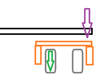

Traction
As soon as you break traction on one wheel (hit a piece of tape, get up on the edge of a field element (ie trench footplate, switch footplates, switch floor protector), start pushing another robot, have weight dynamically shifting onto outside pod wheels through a sweeping turn), your heading will whip around and the algorithm will need to cut power at that drive pod.
That could get mitigated with advanced* module suspension, mechanically damping the bearing, a servo/pneumatic-actuated brake, or all of them.
It looks like you have linear “contact suspension” right now which would work for a single point of contact, but it’s not clear whether the inside wheel will get held down through a sweeping turn with the current setup.
Dynamic load purple needs to get distributed to inside wheel green
Targeting a field performance closer to an old point-and-go crab drive rather than a modern swerve might help you bound the problem better and get the robot on the field.
For a tank drive it’s pretty easy to assume both sides of the robot have traction - it is hard to assume that all 8 contact patches on this robot have good traction, which introduces a potentially very large non-deterministic error term in the physical plant. The effect of the delta of velocity controlling the heading of the pod therefore is also not deterministic in this design.
