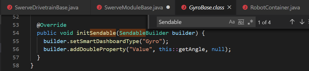

To use the gyro widget you need to implement the sendable interface. Then you just have to call initsendable in a way that is compatable with the gyro widget. Check out the initSendable() section of the WPIlib gyro and you would probably know how to do it :slightly_smiling_face:

This is what the WPILib Gyrobase class does. You can write something similar, but change the method reference in the addDoubleProperty() method to something you want to display.

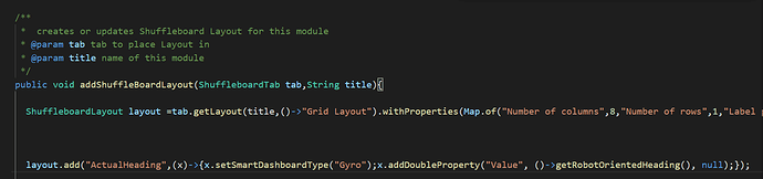

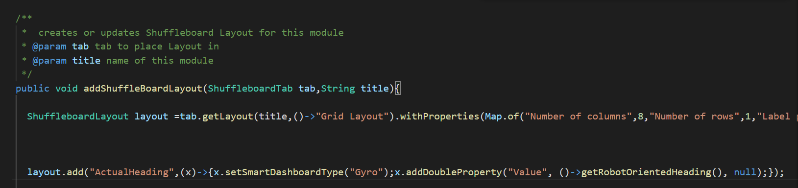

You can also directly pass an anonymous sendable to shuffleboard in one line using lamba expressions, which makes it much more compact. This is what we did:
Thank you! This is exactly what I was looking for.
