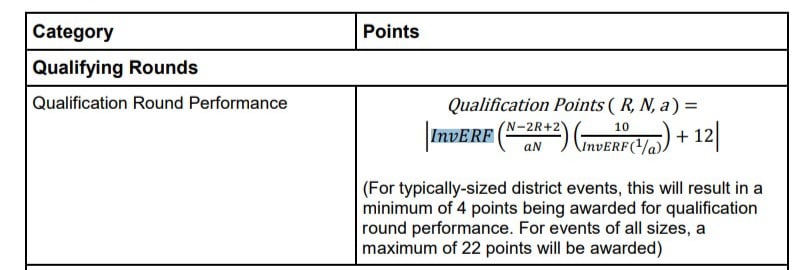

Hi, can someone explain how the DP calculation works here?
What do the variables mean?
I suggest checking out section 11.8.1.1 Qualification Round Performance. From that section:
Breaking this down further, the Error Function and its Inverse are non-algebraic functions with uses in heat transfer, among other things. But that isn’t important–all that matters here is that the Inverse Error Function (erf^{-1} or InvERF) takes in numbers evenly spaced between -1 and 1 and outputs numbers in a bell curve shape.

For the formula itself, we start by by zero-indexing the ranks so that best is 0, second best is 1, etc.
\displaystyle{R-1}
Nest we divide by the number of teams to get the rankings as a number between 0 and 1.
\displaystyle{\frac{R-1}{N}}
Now negate the whole expression to put the best team at the highest number, and rescale to give a number between -1 and 1.
\displaystyle{1-2\frac{R-1}{N}=\frac{N-2R+2}{N}}
Real quickly, take a look at what happens to the invers error function at 1 and -1. They spike off to infinity! This is because with a bell curve, you have an exponentially decreasing–but still positive–chance of getting an arbitrarily high number. Let’s limit ourselves to two standard deviations by scaling our input to be between ±0.94 , by dividing by \alpha = 1.07.
\displaystyle{\frac{N-2R+2}{\alpha N}}
Finally, we take the inverse error function to get our normal distribution.
\displaystyle{InvERF\left(\frac{N-2R+2}{\alpha N}\right)}
Divide by the maximum value to get an output between ±1.
\displaystyle{InvERF\left(\frac{N-2R+2}{\alpha N}\right)\left(\frac{1}{InvERF(1/\alpha)}\right)}
Now rescale to get a number between 2 and 22, centered at 12.
\displaystyle{10\cdot InvERF\left(\frac{N-2R+2}{\alpha N}\right)\left(\frac{1}{InvERF(1/\alpha)}\right)+12}
\displaystyle{=InvERF\left(\frac{N-2R+2}{\alpha N}\right)\left(\frac{10}{InvERF(1/\alpha)}\right)+12}
Finally, round up to get an integer value.
\displaystyle{\left\lceil InvERF\left(\frac{N-2R+2}{\alpha N}\right)\left(\frac{10}{InvERF(1/\alpha)}\right)+12\right\rceil}
Note that because we zero-indexed our rankings, we have a “rank 0” but not a “rank N”. This means that we do see 22 district points at the top, but at the bottom we usually see about 4 instead of 2.

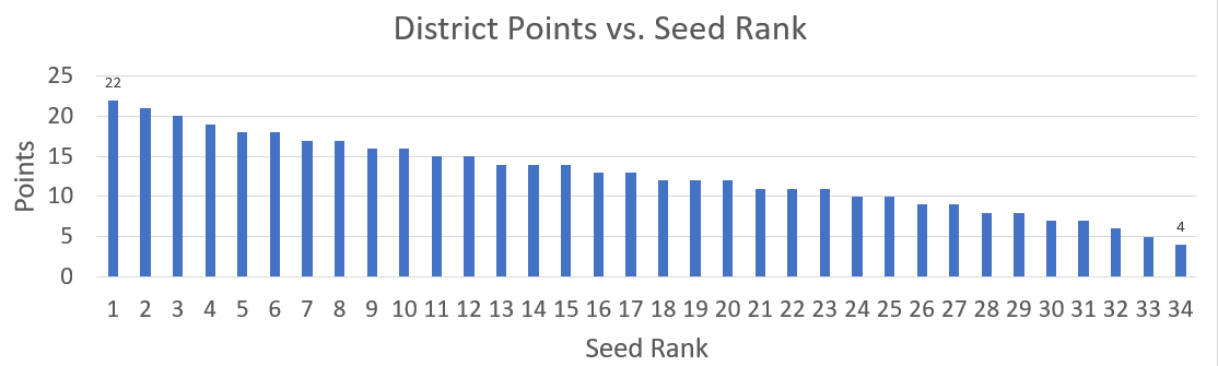

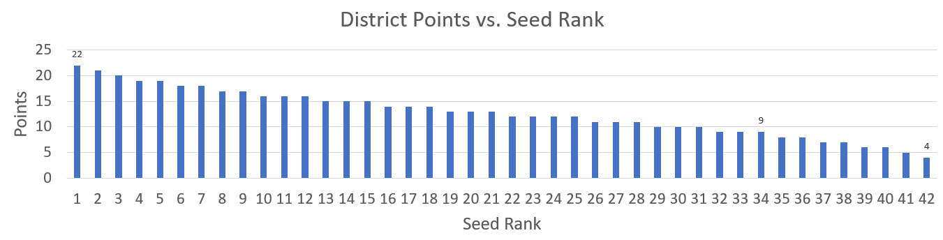

A couple of examples:
Smaller district, with 34 teams competing:
Larger district with 42 teams competing:
