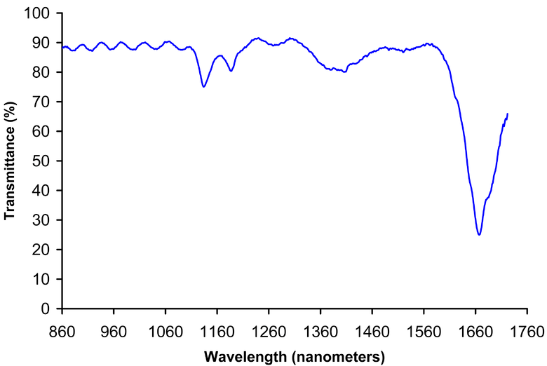

If memory serves, the most common infrared LED emitters have peak wavelengths of 850 or 940 nm. In this graph stolen from Wikipedia the transmittance of polycarbonate is about 90% at those wavelengths. From this somewhat sketchy mix of evidence it seems that if IR sensors can detect polycarbonate, they won’t do it very well.
They absolutely will, and it will be absolutely insanity to try and get it to be consistent. If you get head-on to a very glossy finish it can work, or if there’s schmoo on the PC surface it can trip, or…

It also is dependent on how the polycarb was made/extruded. They can vary somewhat and though they look clear to the naked eye, they refract light both visible and invisible in weird ways
