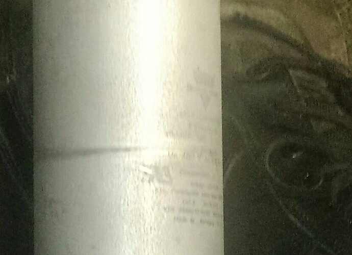

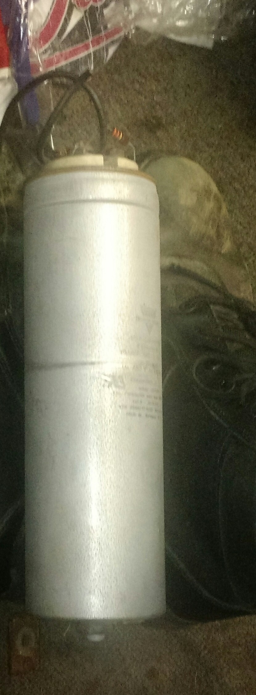

I gather from the link that you used a 1000mmf capacitor. If that is the case then it was appropriate for your design and should not have been a problem. 1" x 5/8", 1000mmf is not “large” in my experience. Our transmitter power supply has two 2 mmf 40kv caps. They are oil filled, and are in a steel can approx. 36" x 30" x 6" not including the standoff insulators. That is my definition of “large” and they would produce a completely different method of evaluation when used on an FRC robot.
Brando,
My info is after the fact and I can only gather from the reports that it appeared that this event only was facing a variety of modifications. The number of elim modifications is certainly on the rise this year but varies wildly from event to event.

As the mentor that attempted to deal with the issue, I would like to make it very clear that the issue was with the interpretation of the rule, not with the RI’s conduct. He did not understand the rule (R49: “… shall not produce voltages exceeding 24V”) has nothing to do with ratings on parts. Debates on electrolytics, over rating, ESR, etc are a completely different issue.
In our case we were using an over rated part as it supplied the capacitance value we needed for the application and while not optimal the over rating did not case us any issues. It was not a large enough device that we felt it added any risk to the robot (as an energy storage device). As was already pointed out, it was securely fastened down and properly insulated. Given that the issue was with the rating on the device, I will gently point out that if we had an under rated capacitor, it would have passed with no issues and been a disaster waiting to happen. The LRI also did not feel comfortable ruling on the issue, in my opinion.
I completely understand that RIs and even LRI are not going to be masters of all aspects of the robot. However, given that under rating can cause serious safety hazards, if CUSTOM CIRCUITs are going to be allowed, education in how to appropriately inspect them is likely a good thing.
Having said all that, I would like to again empathise that both the RI and LRI were polite and professional throughout and their intent was clearly to inspect according to the rules as they understood them.

Firstly, you are correct about the size.
Secondly, the design team has had many discussions about supplying more power to the drive motors, as peak torque values are produced at way above the available current. If not for R37 & R60 I am sure we and many other teams would have all sorts of “interesting” additions, producing all kinds of additional challenges to inspections. After all we had over 25 lbs of steel plate ballast on this years robot to play with.
Thirdly, [tongue in cheek mode on] if you don’t need a cart or dolly to move it, is it really a large capacitor?
Fourthly, and in all seriousness, both the RI and the LRI did not seem comfortable with issues posed by inspecting CUSTOM CIRCUITS. I can only see these types of additions getting larger and more complex as more and more off the shelf systems become available. As a tiny example of this, we had a NavX, Arduino, and Raspberry PI along with the custom power supply for the LED strips. None of this is covered off in the wiring diagrams (it is covered off in the various rules) and must be a nightmare of non EE types to inspect and ensure compliance. I am honestly curious in how FIRST is planning on dealing with the issue.
