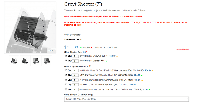

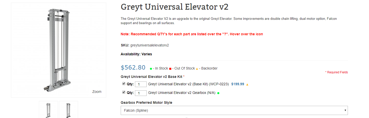

These seem to me to all be in violation of R12:
“No individual, non-KOP item or software shall have a Fair Market Value that exceeds $500 USD.
The total cost of COMPONENTS purchased in bulk may exceed $500 USD as long as the cost of an
individual COMPONENT does not exceed $500 USD.”
In the blue box, the rule also states:
“In summary, if a VENDOR sells a system or a kit, a team must use the entire system/kit
Fair Market Value and not the value of its COMPONENT pieces.”
I assume that WCP wouldn’t be offering kits clearly intended for FIRST that aren’t legal, but I don’t see why these wouldn’t be considered kits that are over $500. Is there something I’m missing here? What makes these allowed?

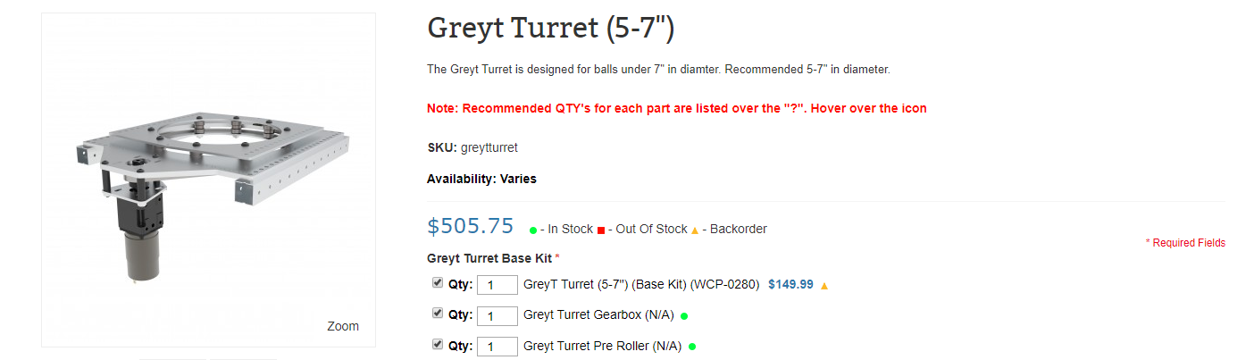

You don’t need everything selected to use the product, or many teams may not.
For example, the “Turret Gearbox” and “Turret Pre Roller” can be used independently of the main product, and the main product could be used without them.
Edit: and ofc, there are fasteners and common components you may not need as you already have them or an equivalent.
While the cost with all boxes ticked may exceed 500$, the “Other Required products” section sells standard sized raw materials- in excess of the required amount. This raw stock is neither a COMPONENT nor part of the kit, exempting it from the price total.

I’m pretty sure if you crunched the numbers on the actual raw material used, the price would be under $500. There’s a reason all of them are just barely over the limit.

I’m not sure you need a 32"x 72" sheet of TINTED polycarb for a shooter (cost: $84), but I haven’t exactly poured over the CAD
