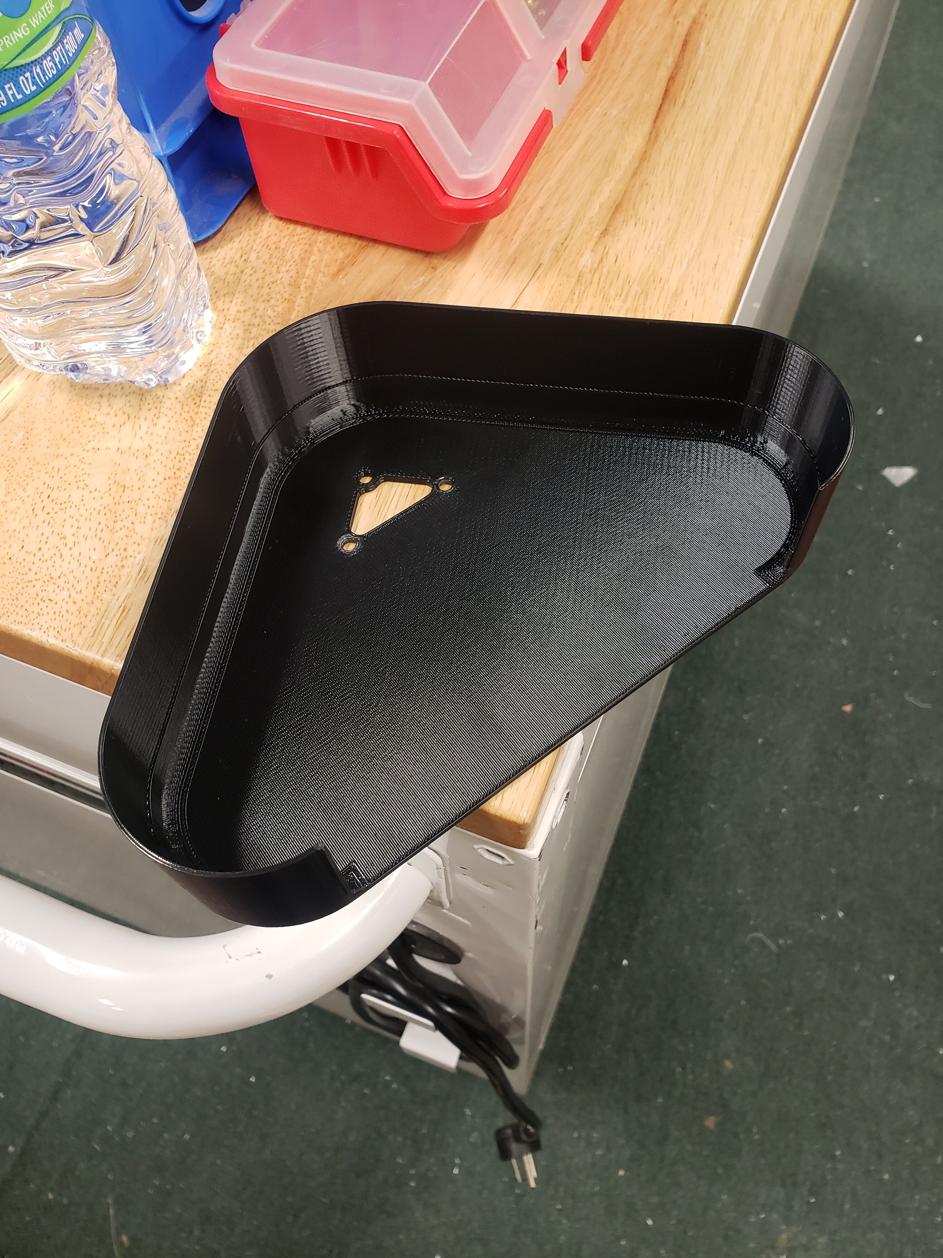

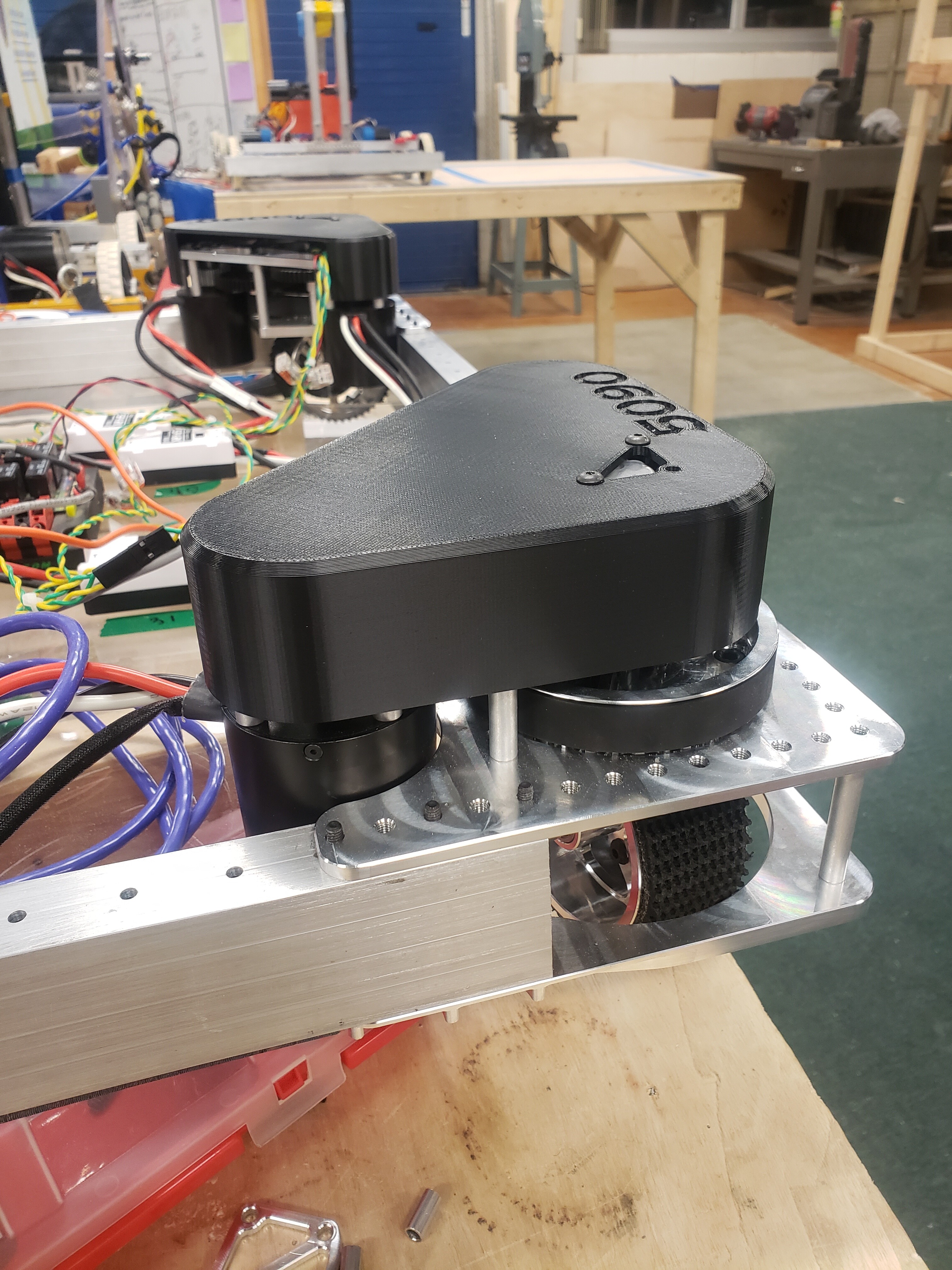

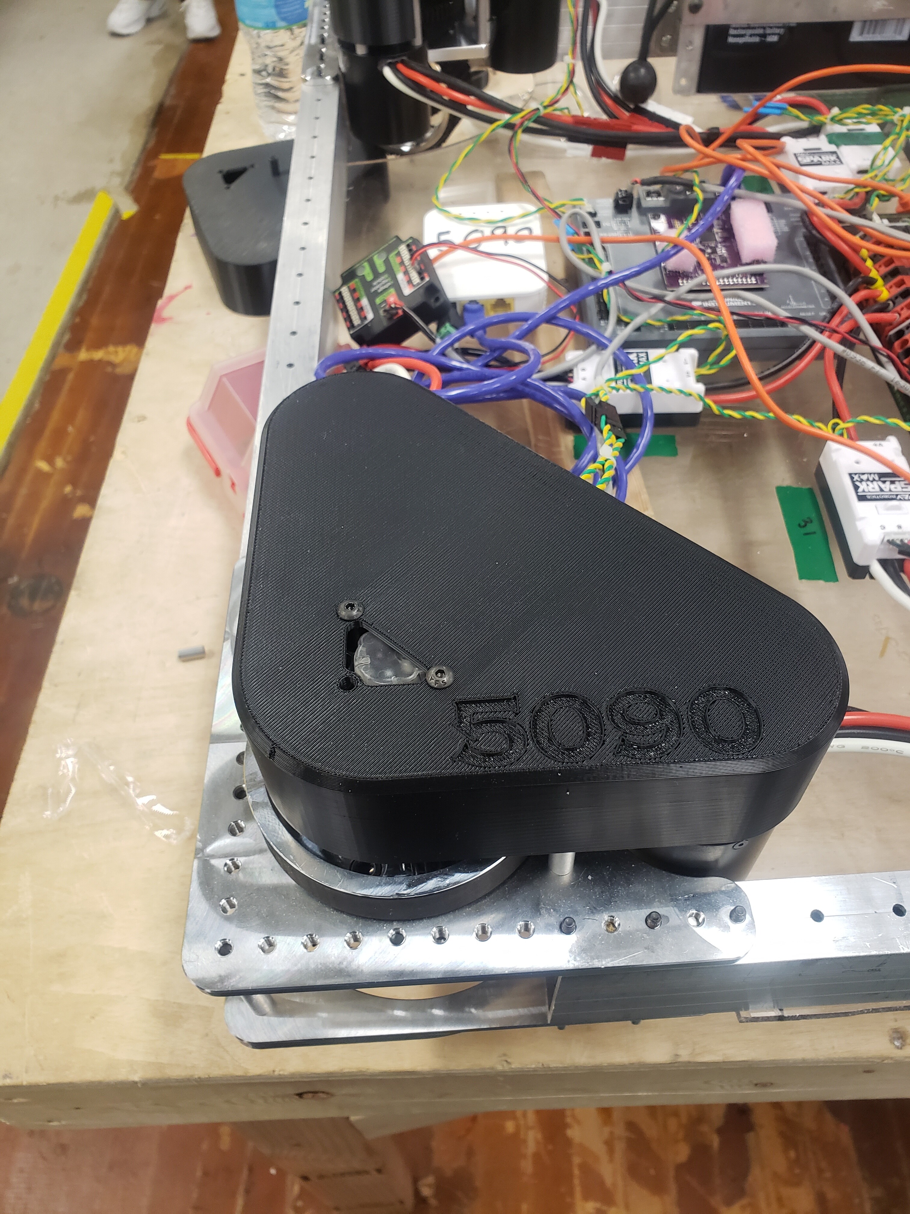

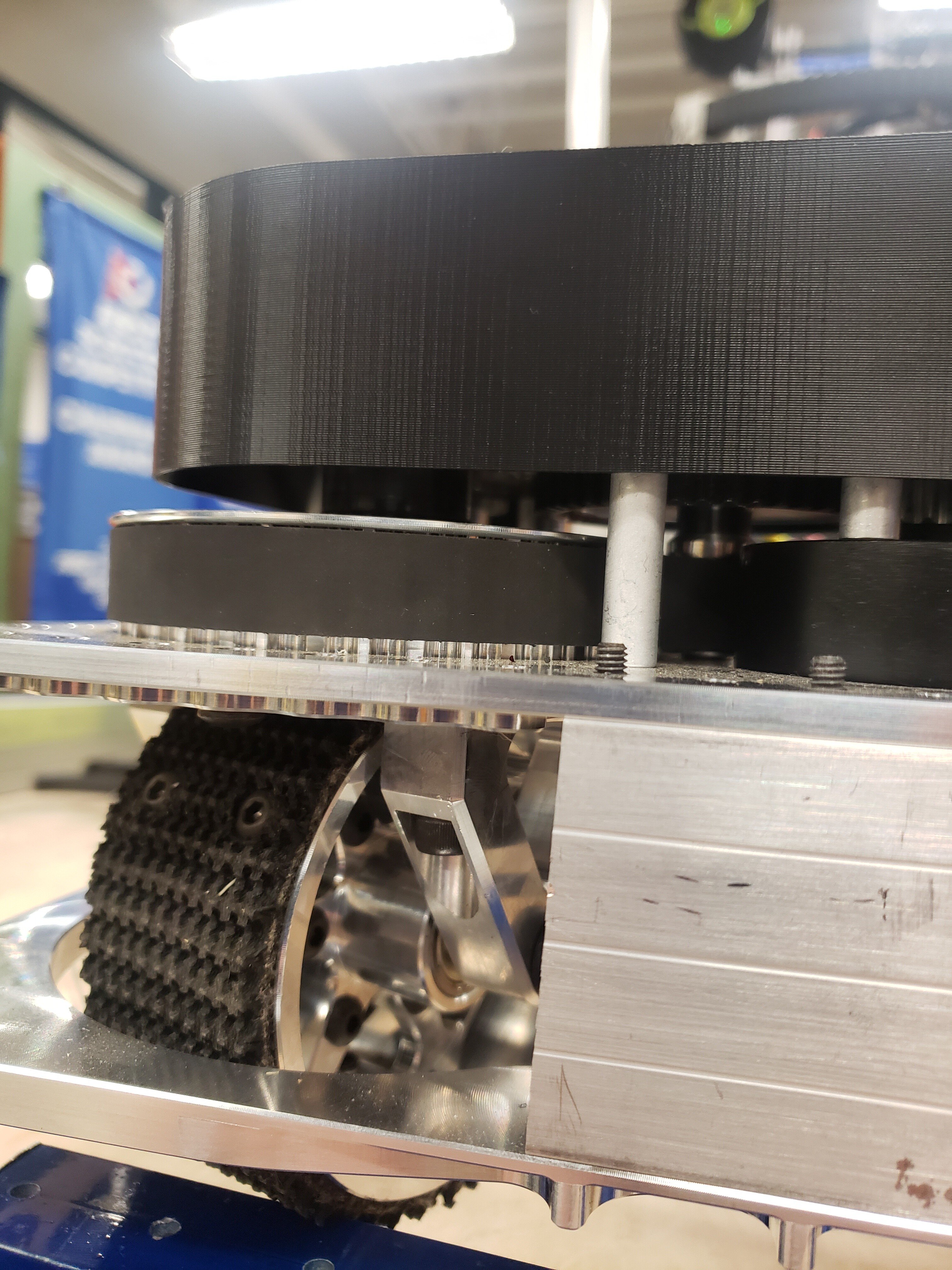

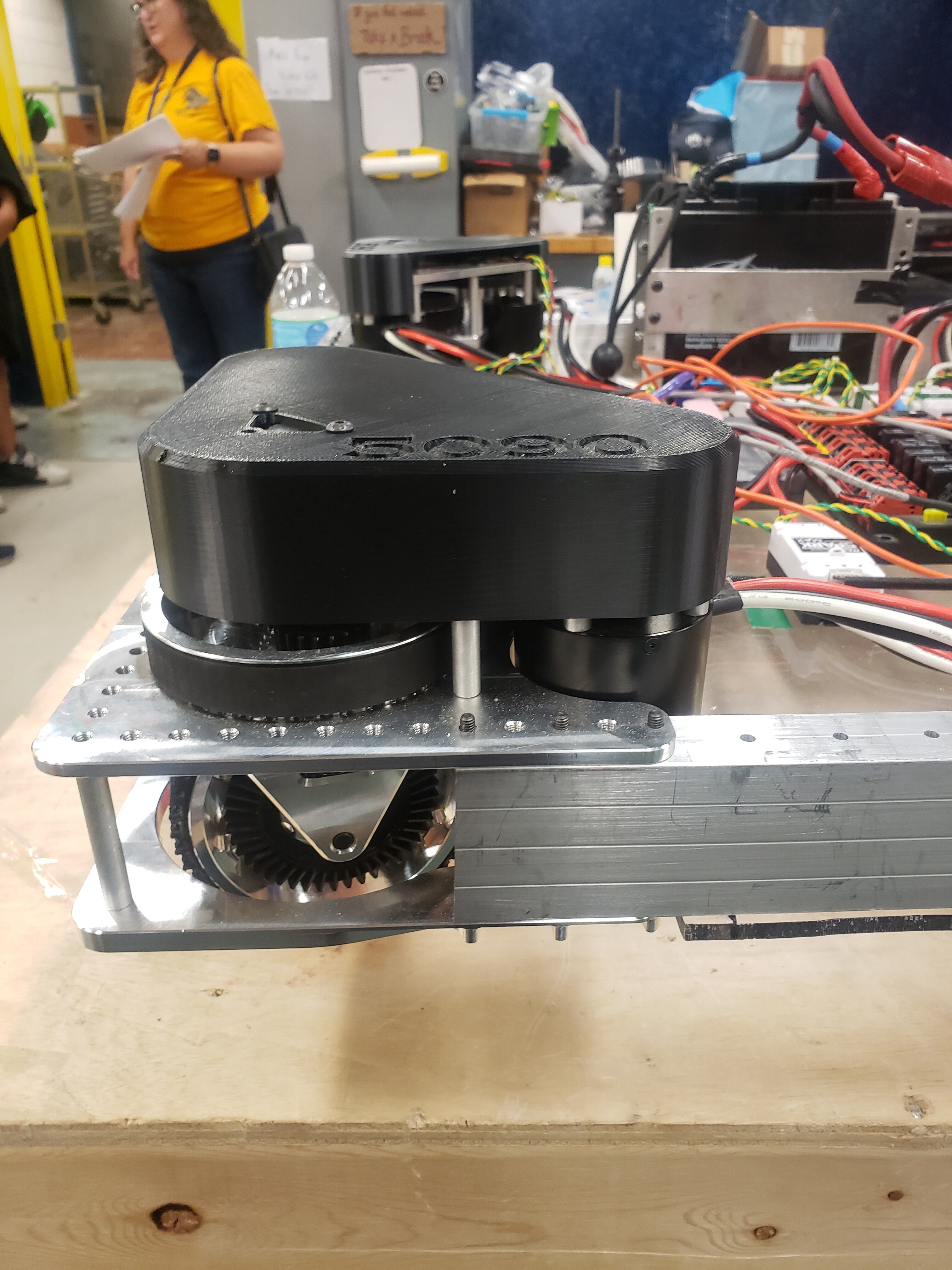

We’re still working on our code, but in the meantime one of our students made these. It’s been through a few revisions and might go through one more, still debating it. Anyways we plan on posting the file for these without our team number embossed on it. Also we are planning on mounting the aluminum guard on top of it but we need slightly longer bolts.

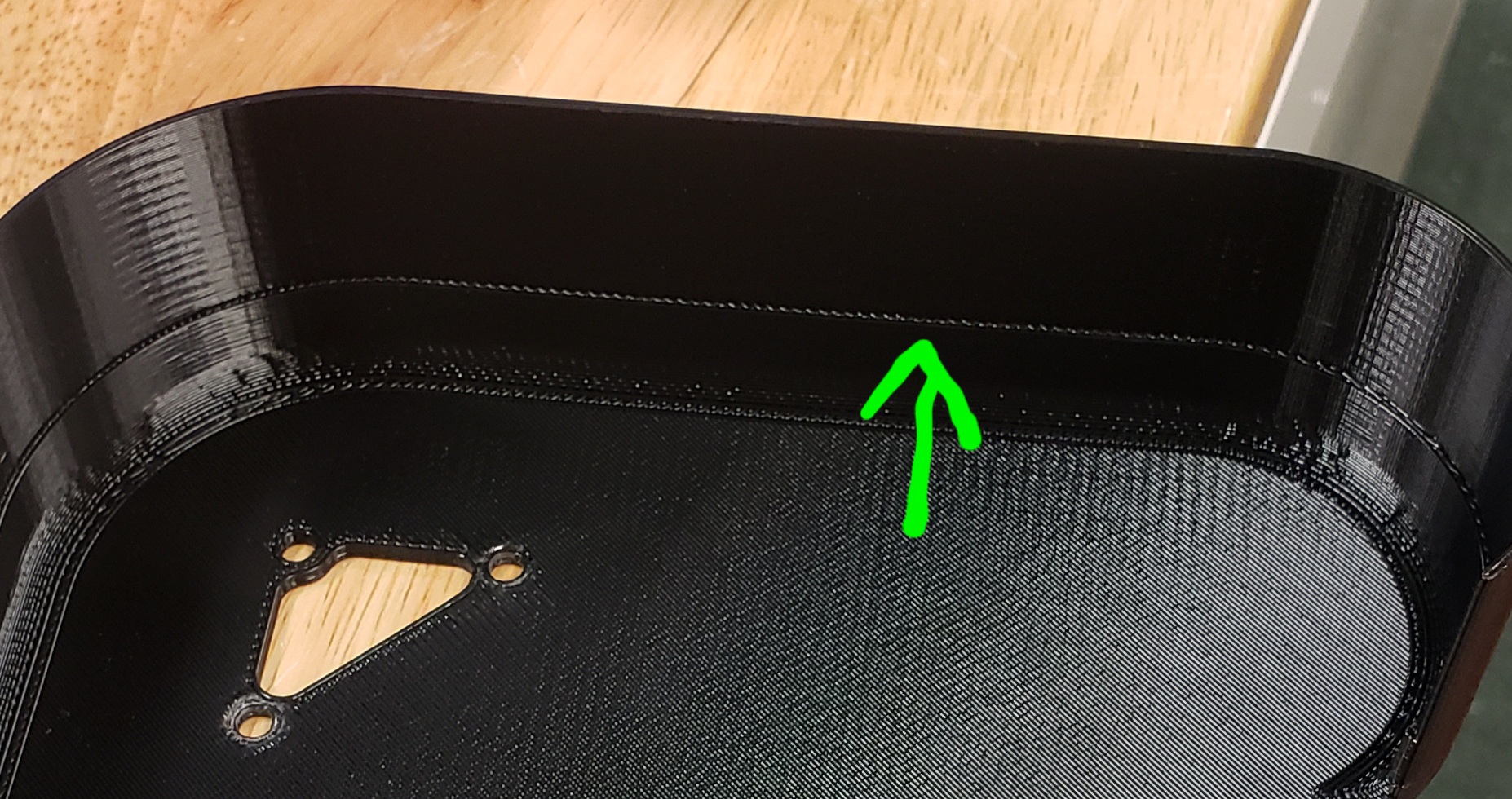

The red circled area now has the spacer stand offs built in. The green circled area is what we might change to have the side shield come all the way around but have notched out slots for the wires to come out. On the second pic the green arrow is pointing to a lip that actually sits on top of the motor mounting plate and supports the cover from being smashed down.
