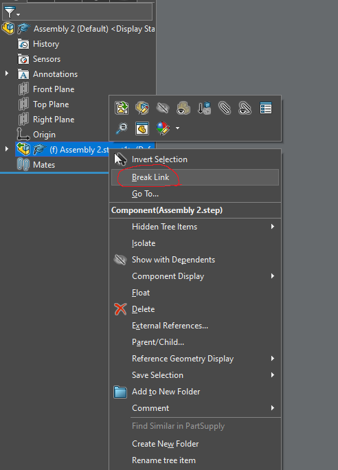

If you ABSOLUTELY want a moving SDS module in Solidworks, you could open the STEP file, break the link (shown below) and save each unique part and make an assembly. It’s a lot of extra work, but you COULD do it.
For your own sanity, it’s not worth it…
I believe you don’t even need to save out the parts from the original file - the parts can be stored inside the assembly file for convenience.
