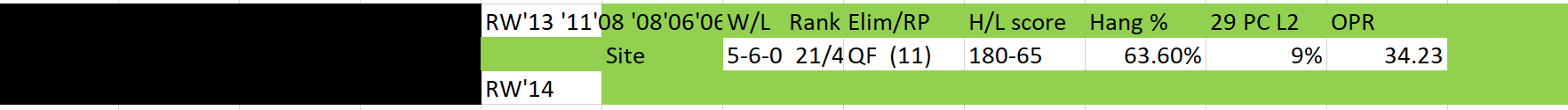

We have a real pre-scouting spreadsheet portion showing here for IR (Teams redacted, a relevant section of it from this season), this shows a team with pre-event and “key indicators” of “expected performance”. You can see some of the shorthand we use in “class” which is past historical performance which we find valuable to fill in gaps. this is meant to present relevant data to compare teams with. Note: the team with numbers has never won a performance on field based BB, which is relevant
In each game, there are certain key metrics that track expected results. The pre-scouting allows us to compare previous results distilled down to likely current results. The class helps us estimate expected strength due to history (three teams represented here with one team having played already) and hopefully as indicated “recent races” or “Expected this year outcomes”
Had we moved on to ur scheduled week 5 we would have had a lot more data pre-collected that is relevant on at least 75% of the field (five weeks of data) from “past performance” this is data from 2020 which is obviously the best most recent data.
Strategy is about not ever being surprised
We try not to track too much, just what indicates performance vs others to determine strength of play and tendencies both good and bad
During the competition its much less about the numbers. Rather what will win in elims based on the field represented. In essence what combo works.
This is based on what works in Horseracing if interested, which i see alignment with in game theory alignments.
