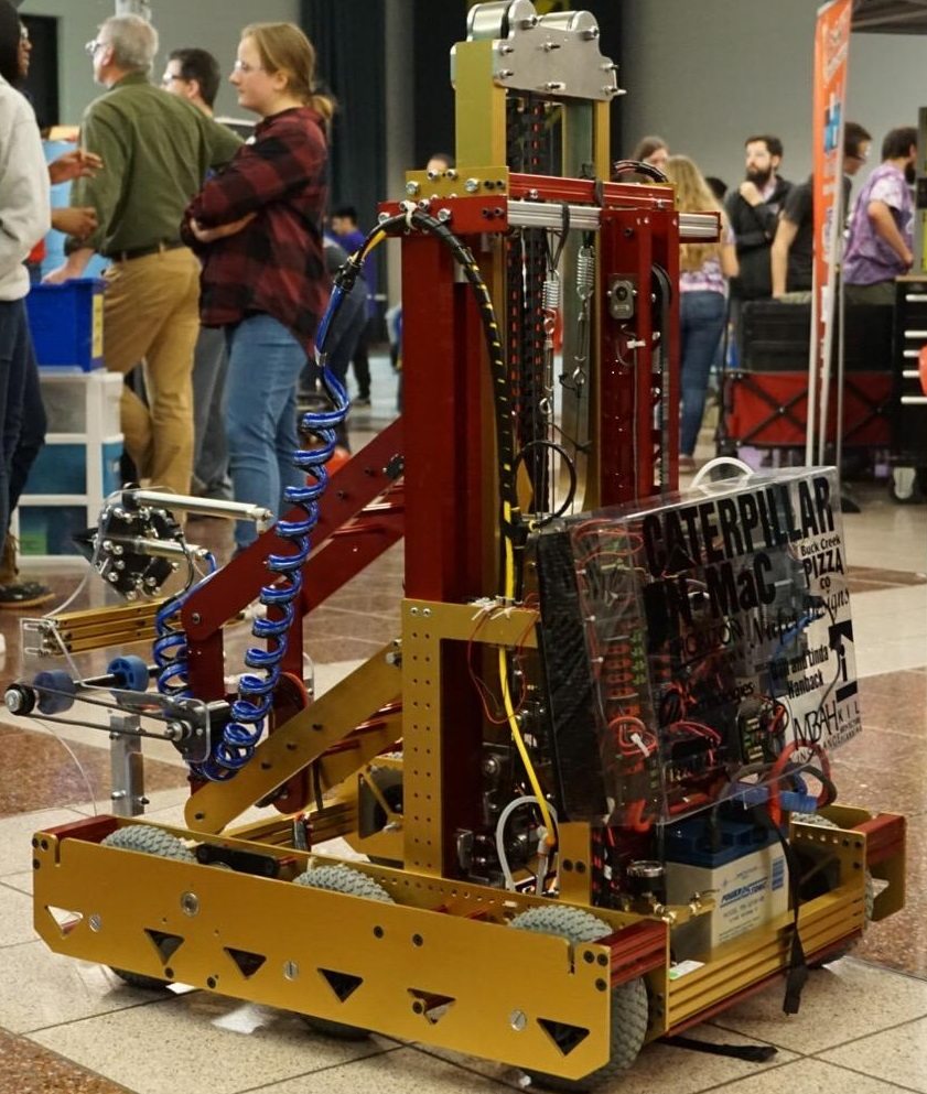

I can’t say we’ve used it. Looks nifty! I’d be a bit worried about applying it to an FRC chassis, seems like you’d need a lot to get the strength (and not a huge advantage over normal 1x1 aluminum)?
We have certainly used it in the chassis. Not for the “whole” chassis but for sections of it. It makes a great standoff material for plate aluminum.
For major drive rails, we like to run Walnut extrusion. Its a little bit heavy, but holds up well. We’ve stacked 2 pieces of peanut on top of each other, but that was for mounting other manipulators to the chassis.

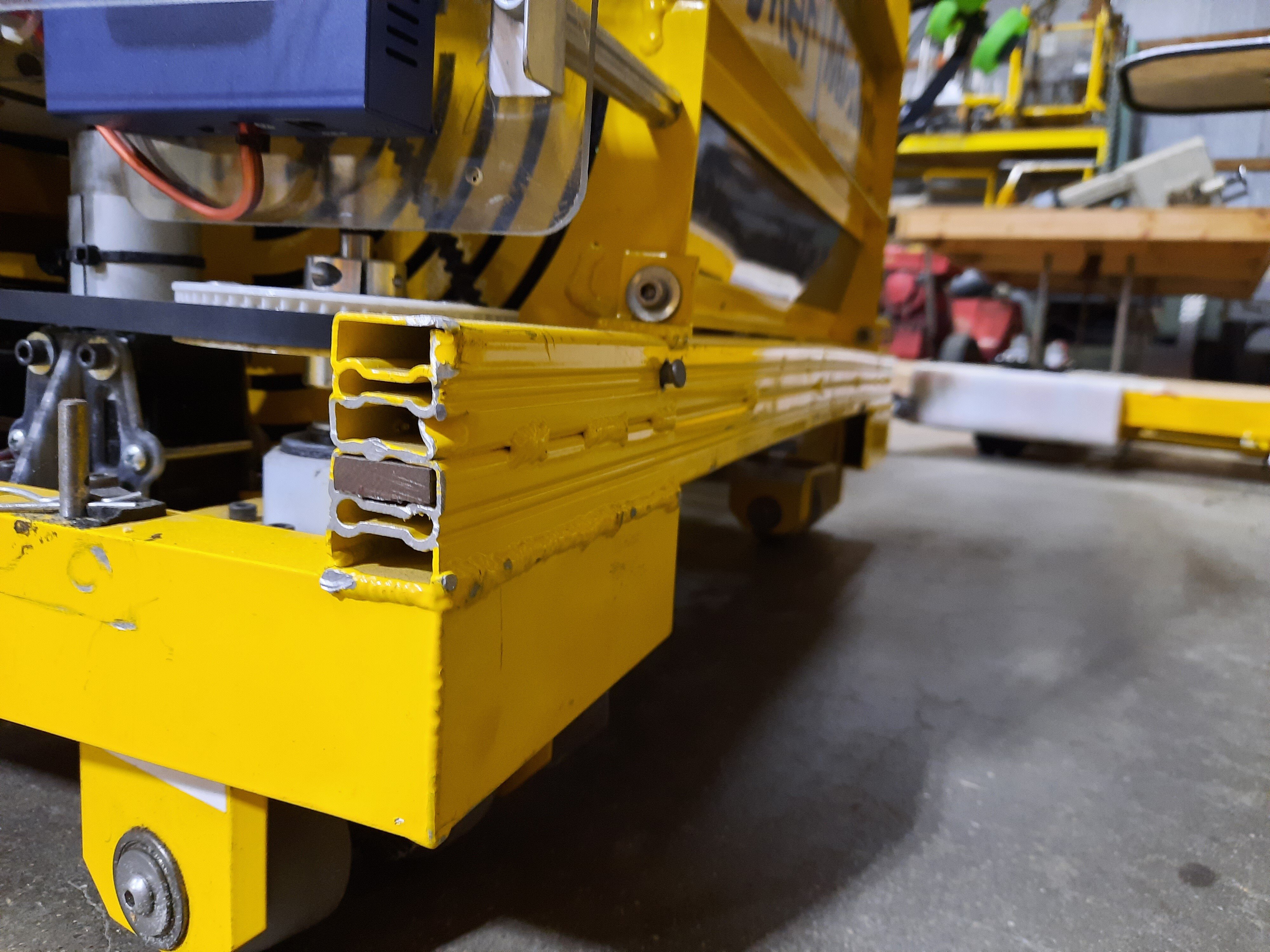

Used 2 lengths on the front of 2017. The secret sauce of strength is the 1/4 x 7/8 4130 steel stuffed in the center.
… and it is still bent.
  1. Build frame with aluminum tube
  2. stuff steel bar into tube
  3. bend tube
  4. now try to get the steel out. No chance.
I blame Jack.
Aggressive driver was aggressive. Who’d’a thunk it? XD
Yeah I thought step 3. was not a planned part of your team’s build process. But as Jack and Cory would argue, “Drive heck out of robot” has always been a Stryke Force standard procedure.
Anyway who cares if you ever get that steel bar out?
