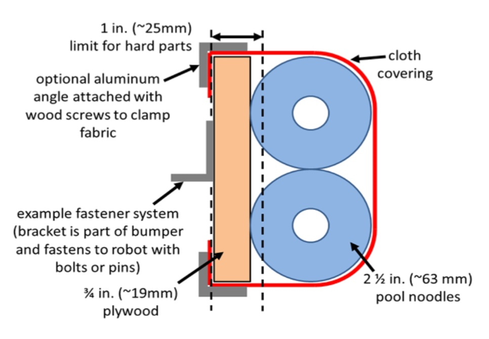

So, what I would do is this: Take the diagram from R408, and use it as a master sketch to extrude the wood, cloth, and foam solids–or maybe a single solid that “holds everything”–for one side. Repeat on the other sides. Figure out R409 compliance and CAD that in.

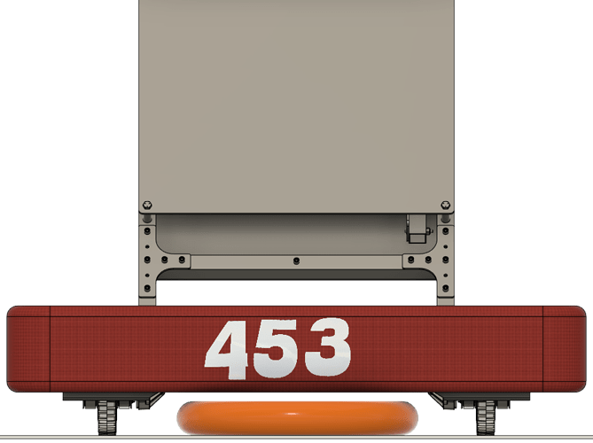

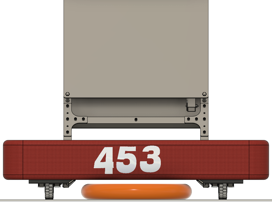

I had made a model for trying to figure out the size and clearance for a note. As you said it’s just a single solid block 5 inches tall and 3.25 inches deep. Rounded corners for aesthetics
