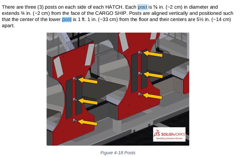

If you didn’t catch it in the manual, there are small pegs that extend out from the side of the Cargo Ship to divide the Cargo Pods. These pegs (if I did my math right which is a dubious proposition) are 20.25" apart. That leaves you with 5/8" to work with on either side of the Hatch Panel when you’re placing it.

Based on watch the “Deeper Space” video, it looks to me like there is a fair bit more space the 5/8" on each side. Can someone confirm the sizes?

Based off the Solidworks model - looks more like you have ~1" on either side of the 19" HATCH PANEL
Does anyone know what material the POST (small pegs) on either side of the bays is made? (is it ferrous)
It’s not mentioned.
Here’s the only mentions of the posts in the manual (page 22)
pretty sure its an 1/2" aluminum spacer from mcmaster, looking through some of the field videos will probably provide insight.

Team-build version uses 3/4" long hex bolts and nuts.

From the video they look like pretty standard bolts, which might allow using a magnetic alignment device (unless they were aluminum bolts for some reason), which would be pretty cool; however, they are not present on rocket, so it is not a generalizable idea.
