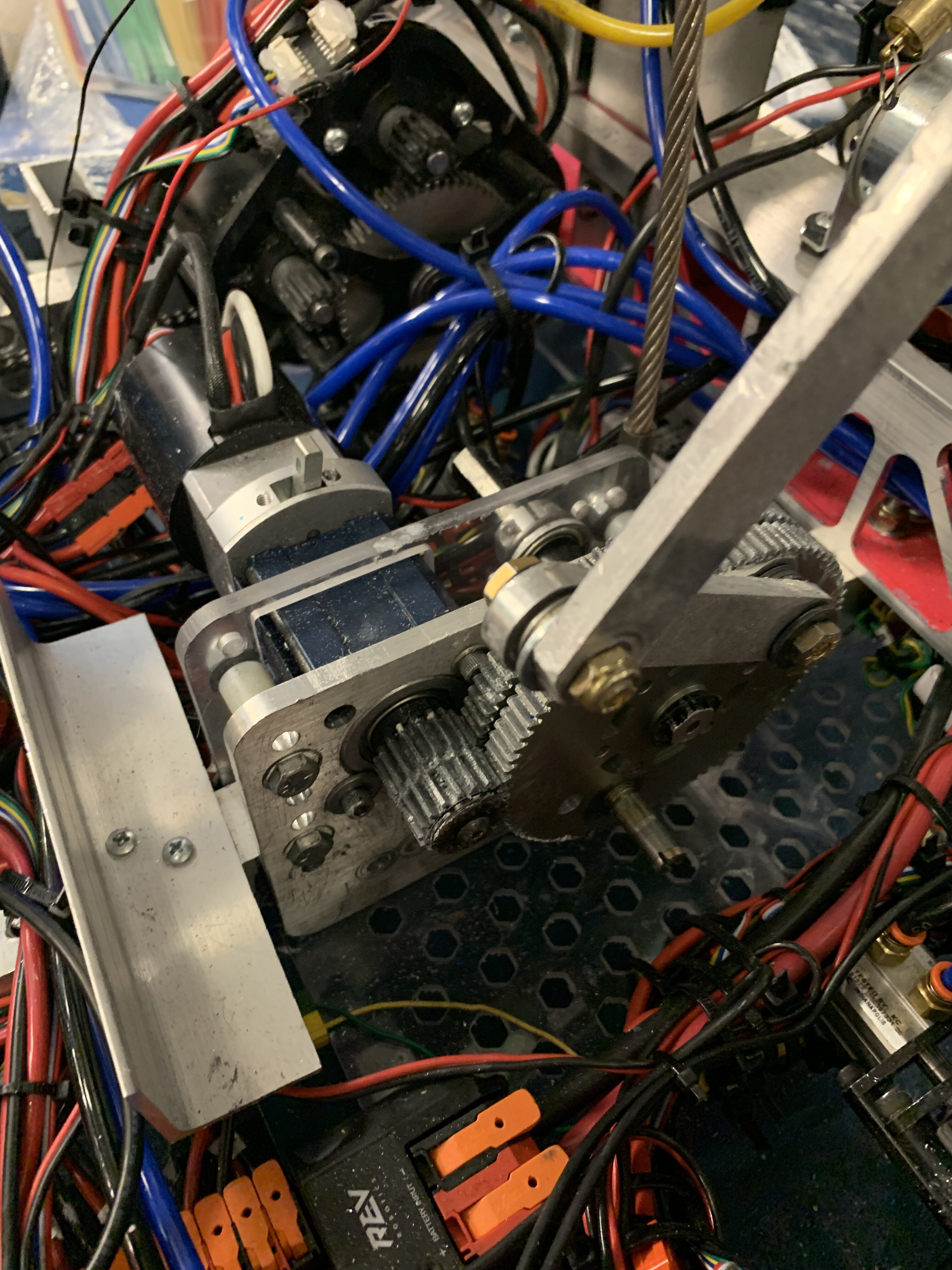

Team 333 used a crank shaft (choo choo) mechanism for our double catapult, the power of the catapult is determined by the spring we use, the path/ trajectory of the cargos being launched is determined by the design of the fingers( the angle the cargos when they leave the place they are landed on)

Not a good idea. But one of my favorite kickoff ideas for a catapult: A Flywheel revs up to a set speed, a clutch powered by a pneumatic brake engages it, that clutch is attached to an arm, so when engaged, the catapult arm launches.

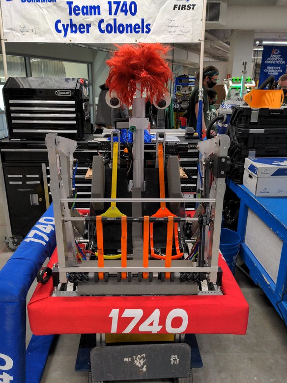

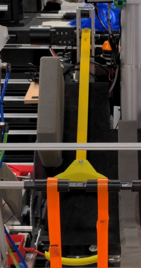

In New England 1740, the Cyber Colonels, had an awesome double catapult IMO. I never got a close look at it, but their reveal video shows it may be as simple as a NEO with a reduction.

Yeah, ours are super simple if you want something easy to try out. Throw a brushless motor on a gearbox with a 25:1 to 48:1 ratio (we liked 36:1 for ~24" arm), mill down a 1/2" hex collar or even 3D print an insert and shove it in some 1" square tube for an arm, then 3D print a scoop for the end (or screw on a collander from Walmart). All of that was mounted to a tower made from 2" square tube and controlled via simple duty cycle and soft limits, with brake mode upon hitting the travel limit releasing the ball. The only real improvement we made over this basic setup was cutting a slot in the hex insert so that we could clamp it on the gearbox output shaft like a hex collar to eliminate slop in the system.
