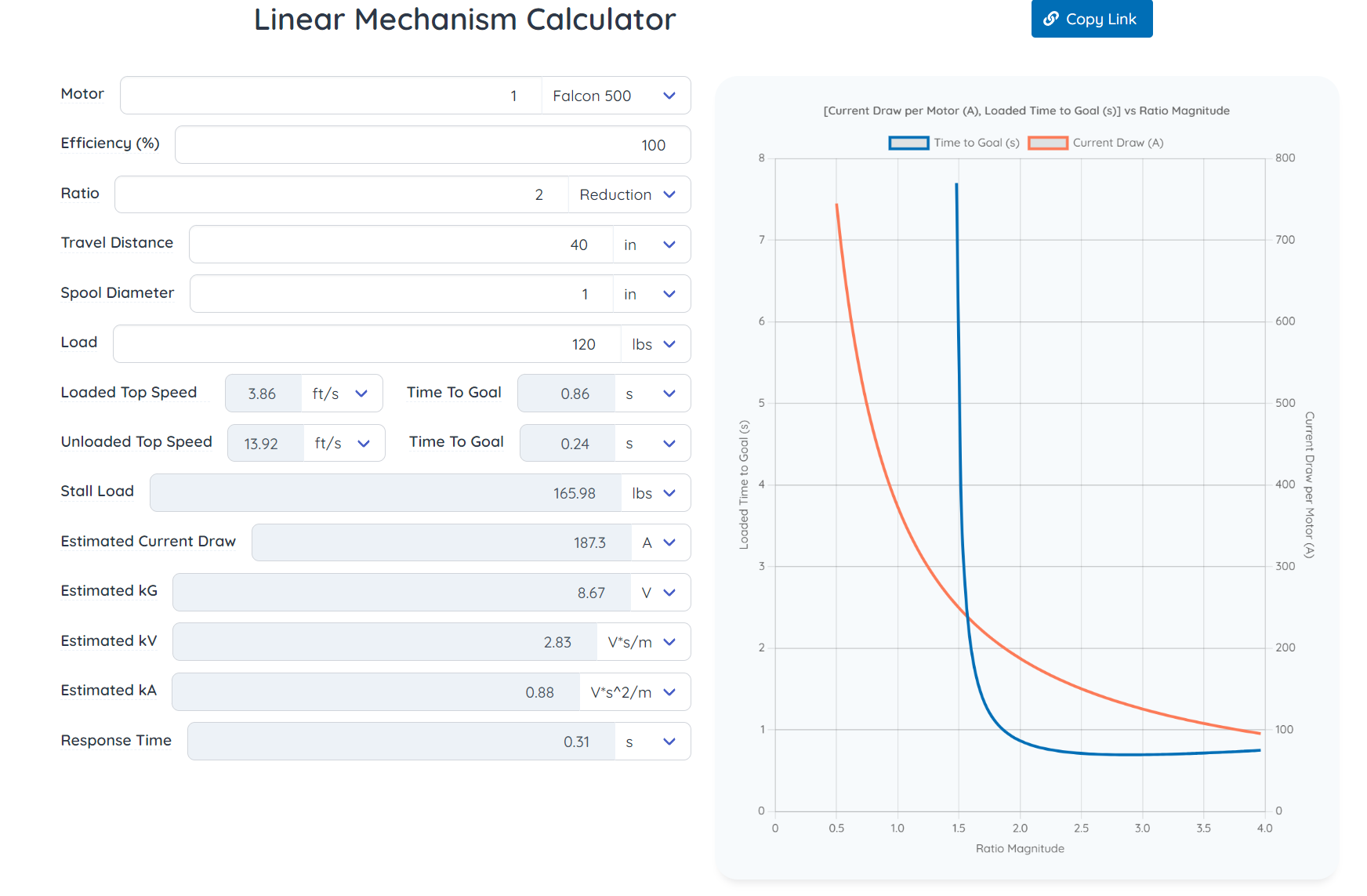

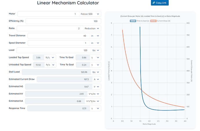

I’ll also recommend you check out the mechanism calculator in my AMB Calculator. It will show you the gear ratio needed to get max power for any applied voltage, and also the loaded speed depending on the gear ratio and load, along other things.
