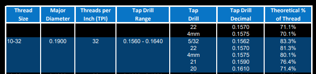

What is pre tap?

That’s the size to use before tapping a hole for the thread size indicated. It’s usually some really odd size.
This is referred to as the ‘tap drill size’ most commonly. To be nice and clear one might also include the % of thread depth the tap drill leaves.
[sauce]
75% thread is common in aluminum and plastics. Steels and titanium often go as low as 50%.

The Vex posters that came in the KOP has the drill sizes, both tap and clearance for the common FRC screws. You can also google drill charts on your phone and find them quickly. It ends up being a mix of letter and number sizes because Americans are weird. Don’t get started on pipe and tube sizes. :slight_smile: Now we are really off topic.
Ah that’s what I thought. Just never heard of it referred to that way
