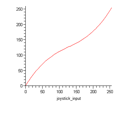

For example, my smoothed out motor curve looks as shown in the image at the bottom of this post.
If you’re wondering what equation I used: it is as follows, in Java syntax (in the C code, I just have a lookup table):
(i is the joystick input)
pwm_output * = 127-42.5*(Math.pow (1.010889286,-i+127)-1)+Heaviside (i-127)42.5(Math.pow (1.010889286,-i+127)-1)+Heaviside (i-127)42.5(Math.pow (1.010889286,i-127)-1);
Heaviside (i) is just a fancy term. By definition,
Heaviside (i) = 0 if i < 0
Heaviside (i) = 1 if i >= 0.
Thus, Heaviside (i-127) is 1 if i >= 127 and 0 otherwise.
It allows me to write the whole function in one equation. So really, this is two exponential functions stuck together.

At the endpoints, I chose to replace several of the last terms with an endvalue. Notice how there are several 254 terms at the end and several zeros in the beginning.*
