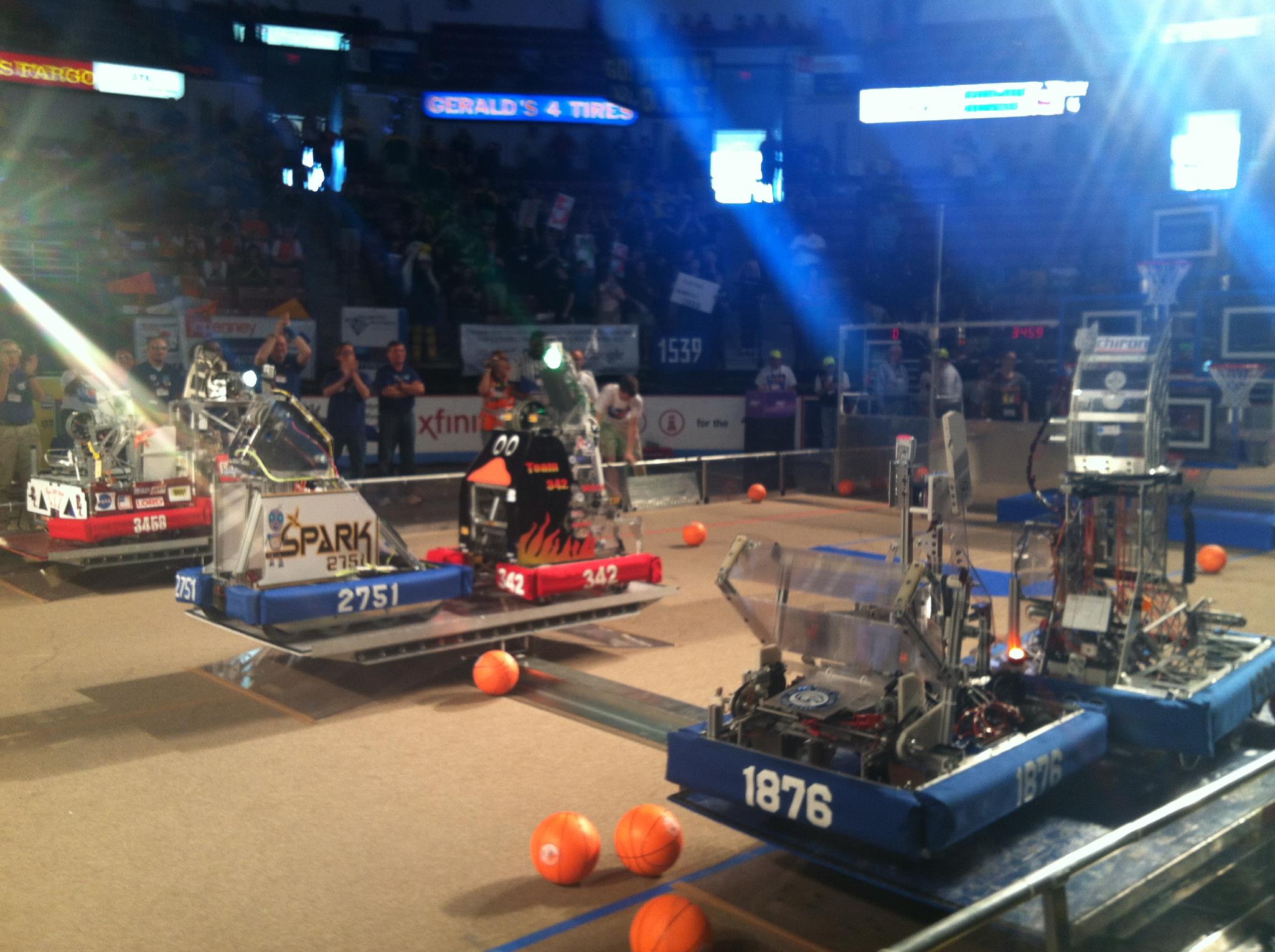

I’m trying to post an image, but it won’t let me. I also can’t get a shareable link because this is a school computer. Any ideas?
Do you happen to know the team number for the robot? IF so we might be able to find a picture by searching it.
2751 SPARK Robotics
Is this what the robot looks like currently?
Not at the moment, this robot was built for the LOGOMOTION competition.
