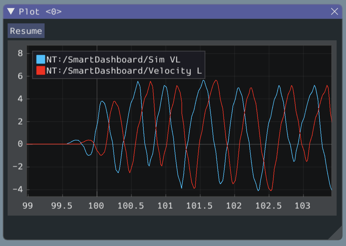

I have been trying to modify the wpilib simulation tutorial to get it to work with encoders plugged into the TalonSRX instead of the roboRIO. I am having some trouble, right now the simulation autonomous teleports around and does not follow the path that the original tutorial did. I’m still pretty new to autonomous as well as simulation so please forgive me if its something obvious but I hit the “lets run it again without changing anything and see if it magically works” phase and figured I could use some help.
My guess is that it is a conversion error or a something with the update frequency of the talons not matching the roboRIO.

From some quick debugging, it looks like the sensor inputs are being delayed from the simulator into the Talon SRX sim collection. Here, I plotted the velocity coming from the simulator vs. the velocity from getSelectedSensorVelocity():
You can see that the Talon SRX is reporting a significantly delayed velocity measurement, causing the instability in the trajectory tracking. I’ve tried setting multiple status frame periods but I haven’t had any luck so far. The only way I got good trajectory tracking was when I used velocities directly from m_drivetrainSimulator instead of the Talon SRX but this is less than ideal and not the intended way to use the simulation framework.

I’m able to reproduce what you have in your plots.
I don’t have a solution currently, but we’re looking into it.
Right, so the root cause is the velocity filtering that happens in hardware:
Normally this isn’t something easily observable because you’d have to plot the raw Talon sensor over the wire against the value from the CAN bus.
You can change the filtering configs either through the API as normal or in Tuner (localhost) while running sim. If you’re simulating sensor noise you may want to keep the filtering (which is why it exists for real sensors in the first place).
What was your solution? I tried changing the window size and sample period but I couldn’t get the trajectory following as smooth as the original wpi example
Changing the filtering configs should improve the behavior greatly - however I’m still able to reproduce a small delay with the window size and sample period both set to 1. We’re looking into what’s causing this so it can be fixed.
