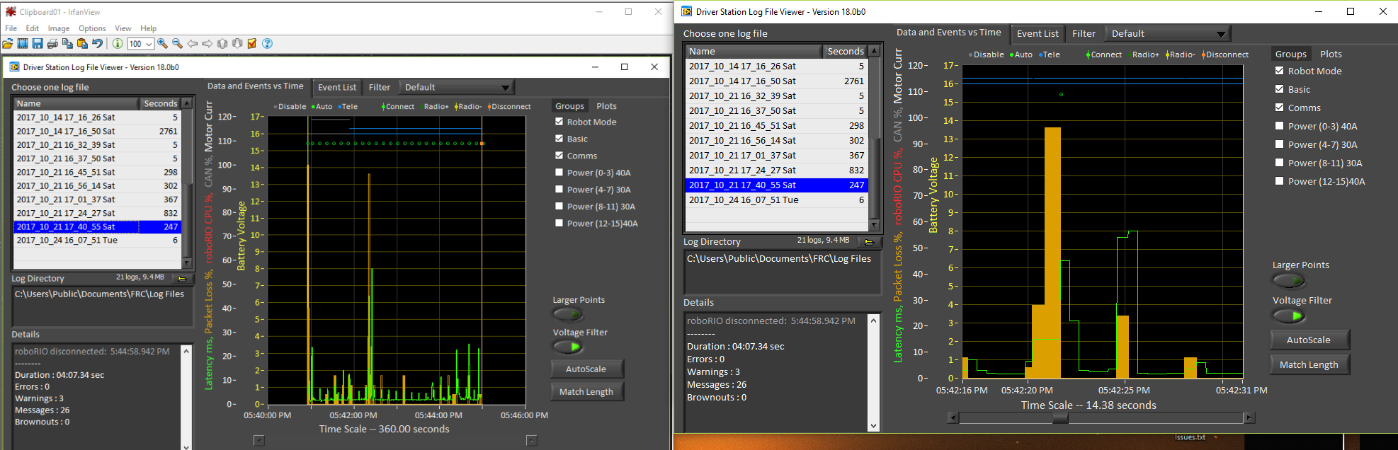

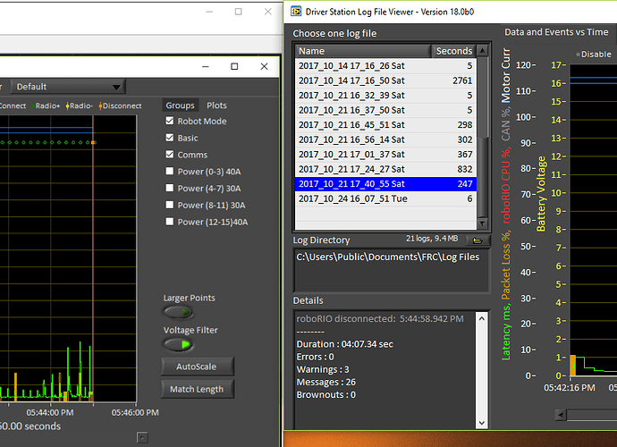

Sorry if this is little late, I made an alternative driver station log viewer which can give you values at specific points on the graph. https://i.imgur.com/vplgBJw.png
Hope this helps!
