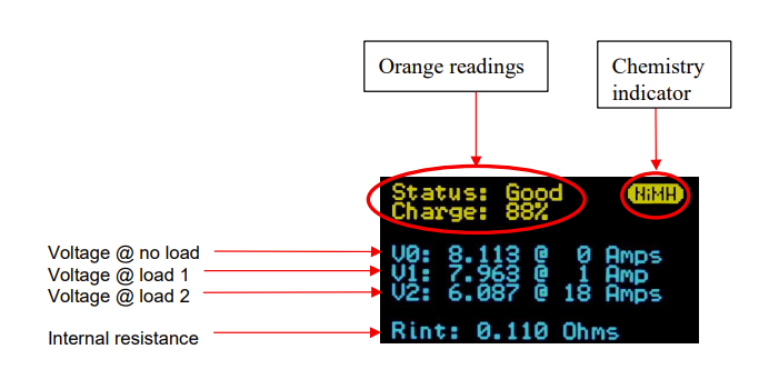

Our team is reassembling an old KOP chassis to help teach programming, and we’ve gotten to setting up the electronics. We wired everything up and connected to the driver station, but the driver station displays that the battery is at 11.8 volts even though we’re using a new battery that measures over 12 volts when we check it with a battery beak. We’ve tried multiple batteries, and checked all the electrical connections all the way up to the RIO. The problem seems to be somewhere between the RIO and the driver station. Has anyone experienced this before or have any advice on how to fix it?

Battery beak reports voltage at a different loads than when the battery is plugged into the robot. Therefore a different voltage. The driver station reports the voltage measured by the roborio.

On the somewhat related topic of Battery Beaks, has anyone noticed different battery beaks giving different readings? This past year we discovered that one of our battery beaks was reading Rint (internal resistance) values about 0.004 - 0.005 ohms higher than the other (throwing off other values as well). Couldn’t think of a good explanation for it, but it’s enough of a difference that we’d consider it significant (it doesn’t sound like a lot, but 0.015 ohms and 0.020 ohms is basically the difference between a great competition battery and a pit battery, IMO).
Did you try cleaning the battery contacts on the battery beaks? That should be the only place you could introduce a difference.
I would assume the other values changed as well? Because you can’t measure the internal resistance directly it’s more of a calculation

I suppose that’s worth trying. Neither seemed particularly more dirty/worn than the other but that could certainly contribute.
I mostly pointed out the resistance because that was the most noticeable (and consistent) difference, voltage values can vary even between multiple checks with the same battery beak so it was harder to get a good idea of the change, Rint tends to be pretty consistent between checks of charged batteries in my experience (TBH, we basically ignore voltage values beyond checking if it’s over a certain point, mostly we compare Rint between charged batteries).
