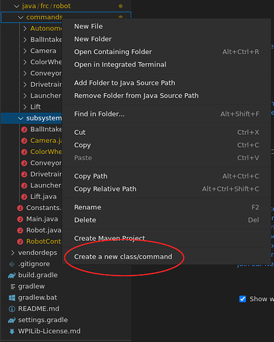

Ok, so I think your issue may be your trying to cast your ShootBall object to a Command, https://github.com/pillagerhuskyhowlers/2021-Practice-code-2.0/blob/03b8626a2a0de1f0367d4780bd4fd88eed67a9b3/RobotContainer.java#L66. I am not a Java Developer so I am not super familiar with how Casting/Converting of Object Types works in Java, but its possible this is like technically working as far as compiling, but when it actually runs, the new “faux-Command” object is missing all the back-end plumbing a Command normally has and thus is blowing up when you actually try to schedule it.
I assume you created your ShootBall Class manually, but there is an “automated” way to add new Commands and Subsystems with all the proper default boilerplate/templating built into the VS Code Plugin by right-clicking the package you want the new Command or Subsystem in and selecting Create a new class/command and following the prompts at the top to select type of class Command (new) most likely in your case, and then Give it a name ie. ShootBall. That will handle making sure your new Command is setup with all the methods and type inheritance it needs without worrying about it much yourself.
I recommend reading over the Command-Based section of the WPILib Documentation for how Commands and the Command Scheduler are meant to operate and be structured.
I actually created the command the way you suggested and listed but still to no luck
