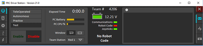

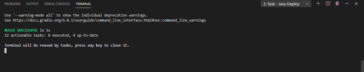

Whenever I Go to driver station after I deploy the code it detects the joysticks and communication but it doesn’t run the code while however it states the build successful

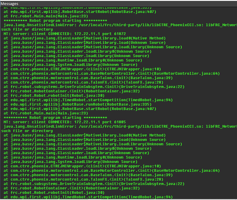

If I had to guess based on the cutoff error message, the version of CTRE’s libraries you’re using aren’t compatible with the roboRIO image you’re using.
Do you have the CTRE vendor dependency? Doesn’t look like it’s properly available to the robot code.

Can you post the output of the “WPILib: Open Project Information” from vscode? I suspect the problem is not that Phoenix is too old, I suspect you are using the 2022 beta version with 2021 wpilib.
that might be the case lemme see
I already did that but I appreciate your help
FWIW, my experience has been that some of the CTRE links make it very easy (as in by default) to pull in the 2022 beta.
