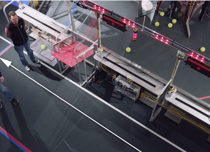

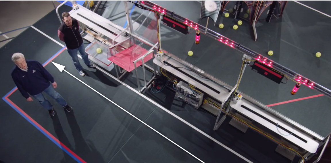

What are the dimensions for where you have to put your computer and controller on. I mean like by the alliance station area. Also what are the hook and loop strip dimensions, and is it hook or loop?
Game Manual section: 3.11.1 Player Station
The shelf is 5 ft. 9 in. (~175 cm) wide and 1 ft. (~30 cm) deep. There is a 4 ft. 6 in. (~137 cm) long by 2 in. (nominal) wide strip of hook-and-loop tape (“loop” side) along the center of the support shelf that may be used to secure the OPERATOR CONSOLE to the shelf.
[FONT=Verdana]The shelf also has two ~4"x4" boxes on it. One for the emergency Stop and a second for a power outlet to plug in your laptop.
So leave room for those.
Here’s a screenshot from the FIRST Field Tour Video for the Alliance Stations , where you can see the full shelf.
