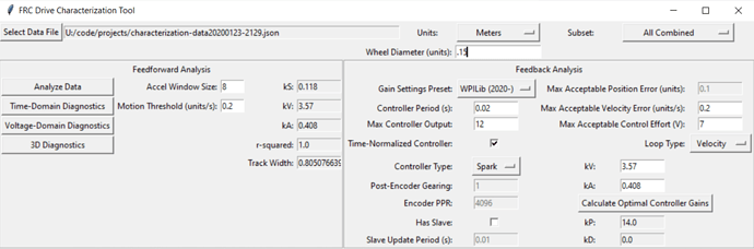

Our results now seem much closer; however our track width is now very narrow (less than a centimeter if we understand the units).
When we run the analysis we see:
And then get
Checked the generated project and the navx stuff looks right:

Try inverting the motors on one side of your drive and re-running (this may require some silly fiddling to get it to turn instead of drive straight). I suspect the encoder inversion when using NEOs is causing problems, and we’ll have to throw an abs() into the calculation.
Yes that was the issue. We fixed it in the code and now have these results:
(low gear off season practice bot) Thank you for all of your help.
Any time; thanks for finding the bug. I’ll fix it as soon as I have the time.
