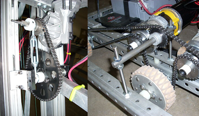

Here’s how we tensioned our chain this year:
On the right is our drivetrain tensioner which we haven’t had any problems with at all. It’s continually adjustable just by moving the shaft up and down and tightening the position with two nuts on top and bottom. The only time our chain jumped off is when one of our IFI wheels failed. The hole for one of the wheel bearings expanded by about 3/16", and caused the wheel to wobble all over the place (hence the chain jumping off) so we had to replace the wheel.
On the left is 25 chain tensioned by a turnbuckle, which actually failed right before ship day because the eye loop that we had closed, opened up. We ended up hacking on a hose clamp to pull the van door motor shaft up - not the most elegant solution, but it works.
