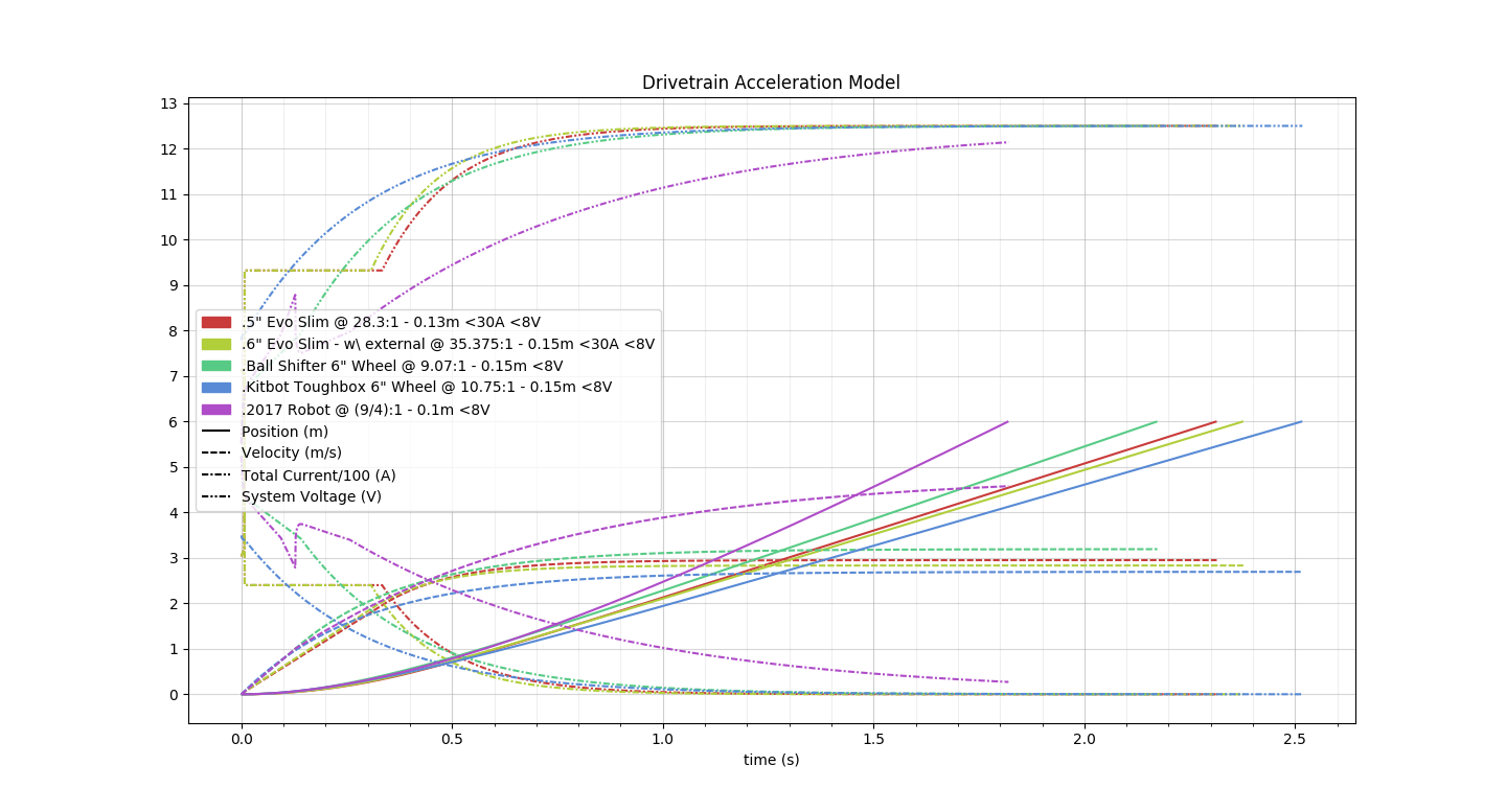

Instead, choosing your drivetrain speed is always a compromise between top speed and low-speed torque. It may seem counter-intuitive, but higher gear ratios (lower “free speed”) will actually give you faster sprints over short distances because you get more torque at low speed. The problem with a high-ratio gearbox is that it runs down the side of the motor torque curve more quickly, so you run out of torque at high speed, which ultimately is why it has a lower “free speed”.
To put the concept into actual numbers we have to start talking about voltage drop, current limiting, mass of the robot, traction limiting and efficiency (friction) of the drive train. Luckily there are several simulators (not JVN calc) on CD that can take this all into account for you. Below is a plot that we made with our own simulator while designing the 2018 robot. You can see that:
  • the Andymark Kitbot with 6" wheels keeps up with every other option for the first ~2s (0.5m), but then starts to slow down.
  • the EVO Slim single speeds, which are geared a little faster, start out slower than the kitbot, but eventually overtake it after ~2m
  • the 2017 geartrain (which was a 2 speed ballshifter is the first to reach all distances, but only if we assume it shifts perfectly at 0.25s
Shifters help avoid the compromise. We ran shifters this year because we wanted to be traction limited at the low end (to push against defense), and also as fast as possible in longer sprints. But shifters have their own issues. They need a reliable pneumatic system, and the shift time itself can impose an acceleration and controllability penalty (our robot would sometimes kick to the side as one side shifted a fraction of a second before the other). Lots of top-level teams are choosing single speed drive shafts these days for those reasons.
