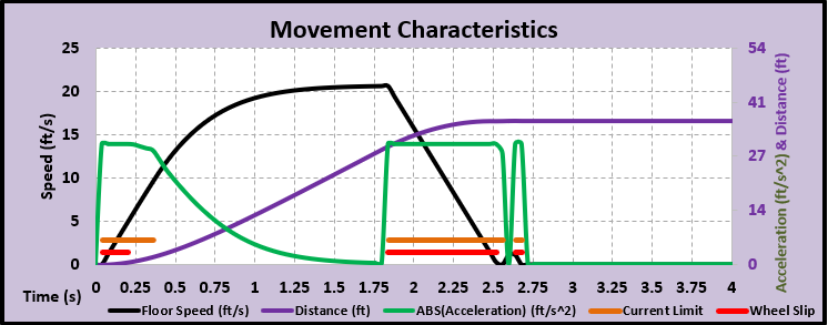

Maybe you joke, but here is a demonstration of possible vs practical. It is possible to hit 20ft/s actual speed on a FRC field with a full-weight bot, but I’d argue that it isn’t practical without a game like 2008.
8-NEOs limited to 40A each with a 4.3:1 gear ratio on a 120-lb bot will net a very reliable 20ft/s in about 19 feet of acceleration. Unfortunately, the robot has to start braking about 0.5 seconds after hitting top speed in order to prevent robot splatter on the opposite side of the field.
Of course, one might say “well just throw the sticks in reverse, and we can stop any time we want!”. Yes, sort of. The pit crew may have some consequences to deal with, since the robot will skid for about 9 feet if it doesn’t topple over first.

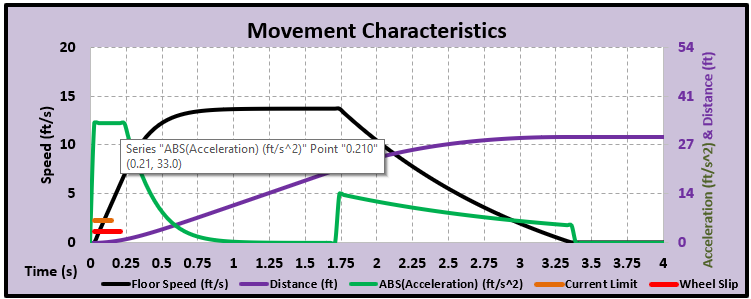

An 80-lb bot does not fare much better (all else equal to the scenario above). While it is able to maintain full speed for almost a full second, it still takes about 6 feet to stop when thrown in reverse.

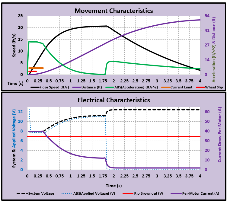

What is going on under the hood in all these lovely acceleration simulations?
Assuming 1g = 9.8m/s^2 = 32.15ft/s^2, this can be done with an 80-lb bot and 4-NEOs @ 60A (or 120lbs with 6 NEOs @ 40A) and a 6:1 ratio on 4" wheels. The hard limit here is the traction. This graph was created with a 1.1 coefficient of friction; 1.0 or less dipped below 1g of acceleration. At 1.1CF, even as I switch the gearing around the acceleration itself remained the same - only the top speed changed.
Interestingly, with 4 NEOs the current limit must be raised to 45A on a 80-lb bot or 60A on a 120-lb bot before the current draw is no longer the limiting factor to getting to 1g of acceleration. So it is possible with just 4 NEOs, but probably not pragmatic due to several live-match factors. For example, the individual 40A breakers could pop if the bot got into the slightest of pushing matches using this configuration.
