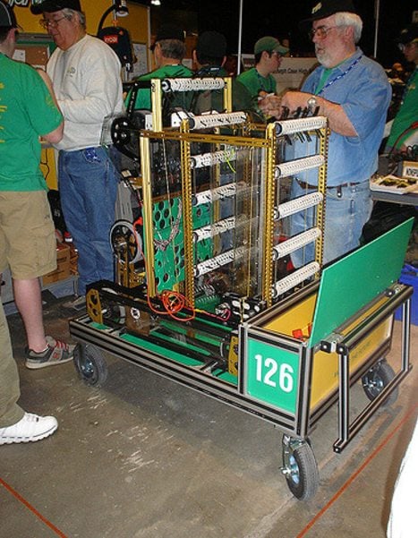

In 2006 Gael Force (126) had a third pair of wheels that would fold down to help them drive up the ramp during endgame.

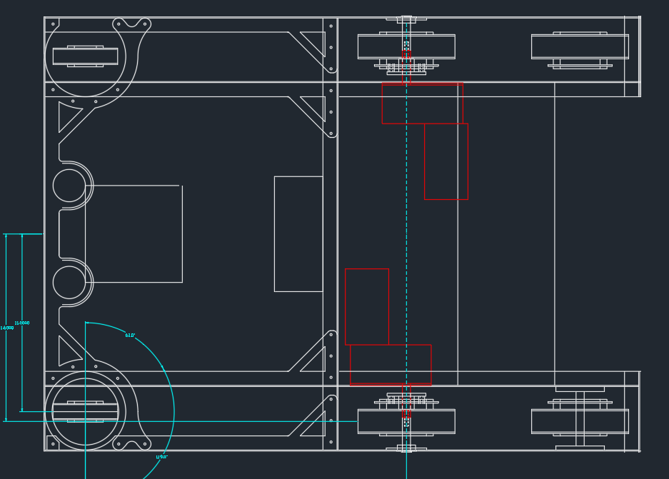

67 also had drop out Ackerman wheels in 08 if I recall correctly. Though given their website seems to have been reorganized I can’t find their technical document on it any more.
Wasn’t on the team at the time, but I pulled up the old CAD on this to check, they don’t drop out / deploy in anyway. It’s 6WD front and middle are 6" wheels, rear is 4" swerve drive steered by a window motor. Front wheel is raised 1/8" relative to the rear and mid. 19.875" rear to mid, 10.5" mid to front.
Ah, I never did have a great picture of them. 08 was a long time ago and pictures were low res :frowning:
Also if you could poke anyone you still know there to get those docs put back up/drop a copy my way I’d appreciate it.
Thankfully :sweat_smile:
Dug up tech notes (I’ll bug them about the website) - looks like my guess from CAD was wrong, steered wheels are not driven.
2008_Tech_Notes.pdf (580.1 KB)
