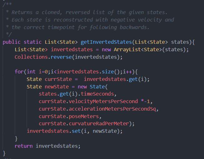

Is there any functionality built in to then drive the trajectory in reverse? Say I got to the end point of my trajectory, and I want to then backtrack (maybe even in reverse) back to where I came from, as accurate to my original trajectory?

Using the reversed config flag lets you follow the path A to B facing the other way, but it doesn’t mean you go from B to A.
You could do something like this to create a new, inverted(?) trajectory based on an existing one given you also set the new config to reverse the original.

good to know! So I guess I could just update the trajectory in place. Thats great.
