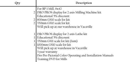

Edit: Maybe @RoboChair can share which DRO Pros kit we got for one of our bridgeports.
Edit 2: Here is what we ordered in our first round of DRO installs in 2015. I don’t know if these products are still the latest and greatest of what they sell image
Measuring the length of the table/gibbs is not how you want to size your scales. You want to size scales based on the axis travel length + a bit of margin so you aren’t hitting the hard limit of the scale before you hit the limit of the axis travel (using scales as an axis hard-stop is no bueno). To do this, you can just max the travel of any axis to one end, measure along the axis travel with a tape measure from a point on the table to some fixed point on the machine or nearby (a wall), then move the machine to the other axis limit and measure again, take the delta, add an inch or two, and you’re in business.
Bridgeports generally have 12" travel on the Y, hence the 350mm Y scale we got. The X axis can vary based on the model.
-Mike
