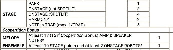

What is going to be the easiest way you guys think to achieve the symphony (chain climbing) rank point?
If we just include the minimum requirement of 2 robots climbing, then having 2 robots harmonized while having a 3rd one parked gets you to 9 pts. Then either the trap or the spotlight to get you over 10 pts. If all 3 can climb, then just harmonizing 2 of them and climbing with the third gets you 11 pts.

don’t both robots get harmony points? In that case just double climbing would get the RP
I think the harmony bonus is per pair. So both robots climb, 6 pts, and then an additional 2 pts as a bonus, that gets you to 8.
yes on the rule manual right above 6.5.3 it says harmony points are given per additional robot meaning 4 extra points in addition to the 6 for the climb which gets you 10
so these are two conflicting responses…
I don’t think the 1st robot counts as an additional robot. The second robot is the “additional” one. If you can get all 3 on the same chain, then that would be 4.
Relying on both teammates being able to climb is quite a gamble. We are going into it, hoping we can all climb, but not counting on it and at that point a hatch is required. Our goal is 2 climbs and a hatch placement for the rp.
The wording “per additional robot” seems to be the point of contention here. If it said “per robot”, then I would say that’s 6+4 points for a 2-robot climb (or 9+6 for 3 robot climb). But per additional means you need something to start with, which I would think is the original 1-robot climb, leading us to 6+2 (or 9+4).
By far the most common way to get the Ensemble RP will be a robot which can climb itself and score in the TRAP. That’s 8 points for itself, plus the minimum 3 needed by one more climber.
