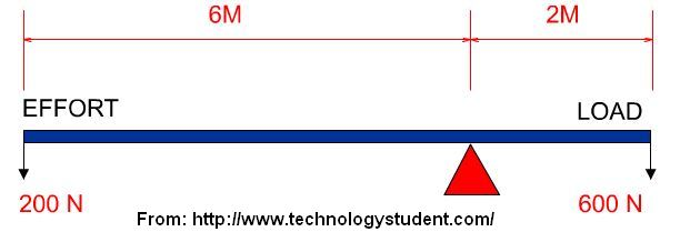

Yes. The 2-D center of GRAVITY with respect to the floor can be diagrammed and located from those four points (assuming it’s a rectangle). I’d add that to be more accurate, the remaining three wheels should be blocked up so that the machine is level when each wheel location is weighed.
Then, the “balance point” or “seesaw fulcrum point” along each side can be calculated using the weights on each corner, like this:
I’d use graph paper (I’m old) to scale off the frame and then the location of the “balance point” on each side using the fractional distance calculated.
Then, connect the two points along the E-W sides with a line, and then connect the two points along N-S sides with another line. Where they cross is the “center of gravity”.
Calculation of the 3-D center of gravity (a point away from the floor) is way beyond my ability to understand physics.
