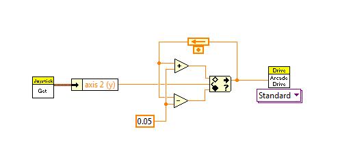

Well, a very simple system to implement that is purely software involves just limiting the joystick values by an Acceleration Limit of sorts.
Essentially it’s using the In Range and Coerce function in LabView (I take it from your post that is what you are using), and the idea is to use the Joystick Axis input as your X test value, and to have your upper limit = (the previous Axis Value + your acceleration limit) and the lower limit = (the previous Axis Value - your acceleration limit). With this very simple functionality, if the input, X, is out of range of either of those values, i.e. it is too much , it will output the coerced x value as (your X value + your limit) until it is within range and reaches the value you requested as X.
Unfortunately, as I’m unbelievably tired at the moment, I don’t think that post was very coherent, so I’m just including a screenshot and hoping that makes this much easier to understand.
For the purposes of the example I just picked a number, 0.05, as your limit, but you’ll have to experiment to see what will work best for your robot.
Frankly I don’t know of any simpler way to implement a limit on the joystick values.

PS- CUSE, what is the limit number (you chose 0.05) referring to?

The 0.05 is essentially just the maximum “step” you want to have the joystick value take in any given cycle of the code–it’s your limit.
For example if you have the joystick full forward and you’re requesting a value of 1, with the limit at 0.05 the successive steps up to 1 will go: 0, 0.05, 0.1, 0.15, etc until it reaches 1. You can speed up the steps or slow it down by changing that value.
Make sense?
If you have any other questions feel free to ask.
CUSE- what is the orange arrow at the top of the code?
That’s a feedback node. Basically data takes one cycle to get from the input (tail of the arrow) to the output (head of the arrow).
Where can I find the feedback node?
programming > structures, right before shared/local/global vars.

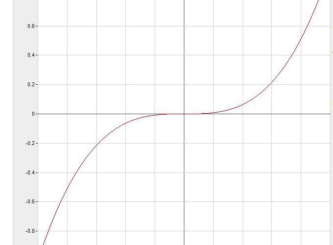

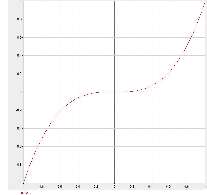

What 399 did was a simple open loop system. We took the joystick value and cubed it. this makes the values non-linear and has some deadband in the motors. The drivers have more control over the speed in the low traction environment.
