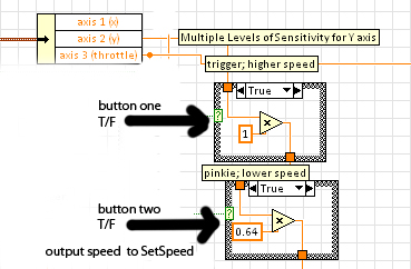

We did a similar thing with 2 multipliers to the Axis Value depending on the button.
In our set up we used only the Y-Axis for the Value. We had a Trigger and a Pinkie Button, so the Trigger was a (y*.65) Value. The driver with the trigger depressed could use the slower speed in addition to the fact he would creep up to the full value on the axis. The Pinkie finger would be another value… depending on what you needed.
It isn’t an elegant solution to the problem, but it worked for us. We didn’t use a standard Tank drive system so Spinning Out was not as much of an issue for us.

I attached our code… and you get to witness my Worst photoshop job ever…
