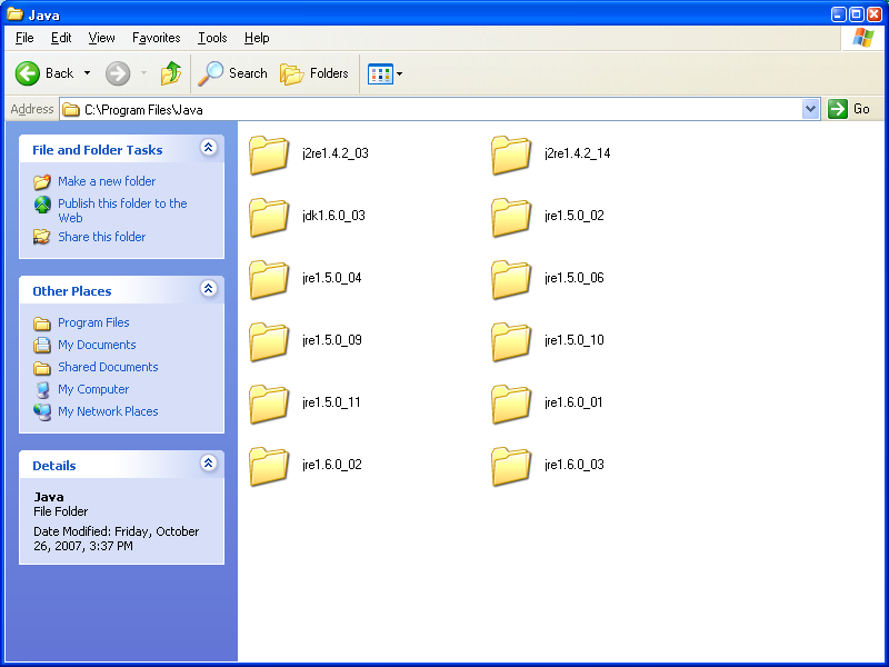

I’ve gotten the Eclipse IDE, but it won’t work on my computer. It says I need the Java Virtual Machine 1.5 or higher, but I can’t seem to find it. Does anyone get me a link to where I can get it from?
BTW, it says I have JVM 1.4.2_14.
The current version of Java is Version 6 Update 3. Here](http://www.java.com/en/download/windows_xpi.jsp?locale=en&host=www.java.com) is the link for the latest version of Java.
It says that I am up to date on the latest download.
I got curious and looked in my hard drive. What I found was that right in the C Drive was the file Eclipse keeps referring to what I have. Moving into my program files, I found the Java folder. Here’s what I found. Now what? Any ideas?
Just delete everything in your Java folder except for the JDK 6.01_03 and JRE 6.01_03. Java doesn’t remove old versions when it updates, since some Java apps require certain versions of the JVM. The good news is that clearing out all of those old ones will probably free up a gigabyte or more of storage space :slight_smile:
