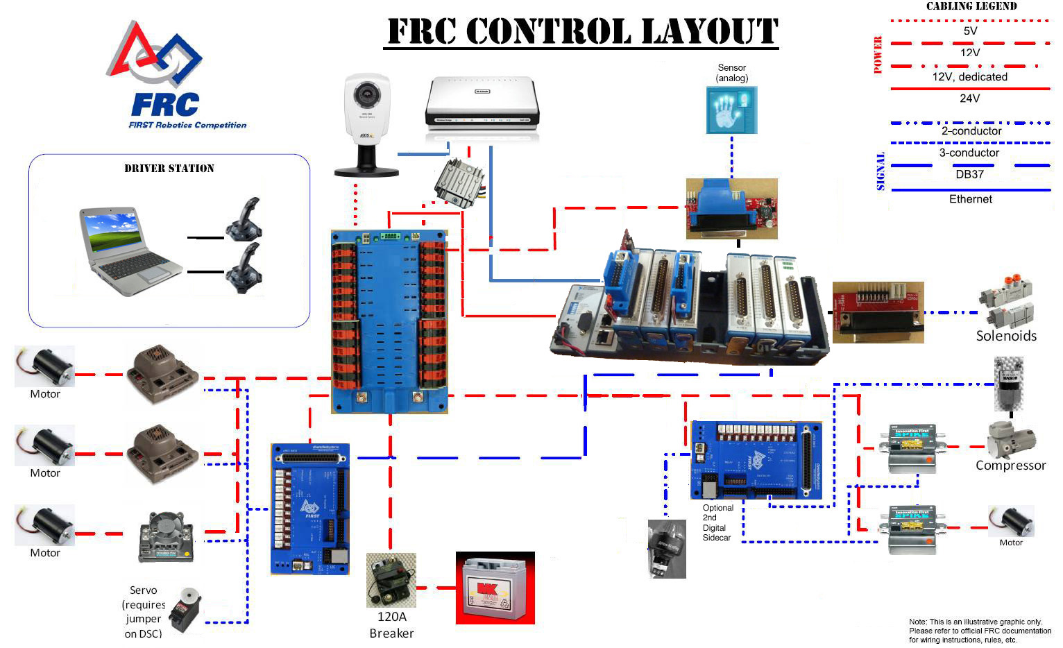

Here’s an overview slide:
http://team358.org/files/programming/ControlSystem2009-/sm_2012FRCControlSystemData-PowerChart.jpg](http://team358.org/files/programming/ControlSystem2009-/2012FRCControlSystemData-PowerChart.jpg)
We usually print out the Electrical diagrams as large as we have a printer for. They don’t fit on PowerPoint slides very well.

Hi Mark,
These are awesome diagrams. What kind of tools are you using to draw these diagrams?
Man Mark, I wish I had that overview document handy at our meeting a week ago… I basically drew it out by hand on a whiteboard while talking with the team!
The wiring diagrams come from FIRST as the pdf’s you see.
In fact, you should get familiar with all the FIRST Technical Data at: http://www.usfirst.org/roboticsprograms/frc/2012-kit-of-parts-technical-resources
I don’t know what tool they prefer.
There are some tools from Atrium, free to FIRST teams, that can be used for this.
The picture was just stuck together using Photoshop. The original came in the 2009 Control System KOP, and I just keep it updated year-to-year.
