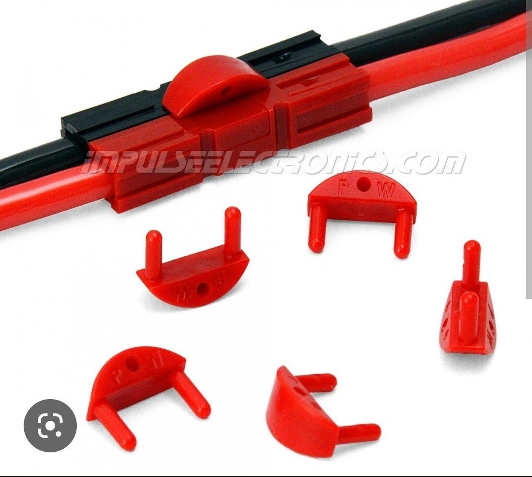

We use Anderson power poles too. They stay together really good but if you were worried about them coming apart there are clips that insert with pins that hold them together or use little zip ties, we’ve never needed to use them though. The power poles connect to each other to make a one piece assembly, only problem we have run into with power poles is if a student isn’t careful and in sures the contact is locked into the plastic housing the wire and connector can get pushed out when connecting the two connectors. For CAN we switched to wagos with ferrules this year instead of communication crimp connectors.

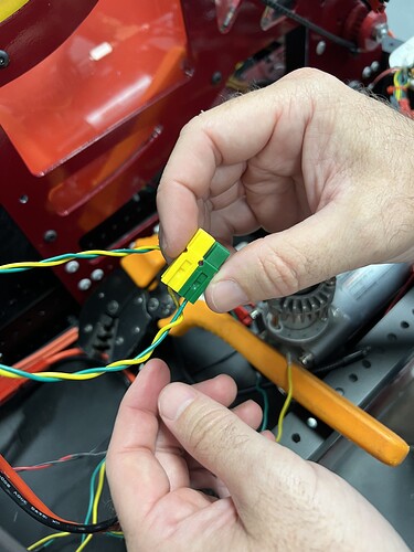

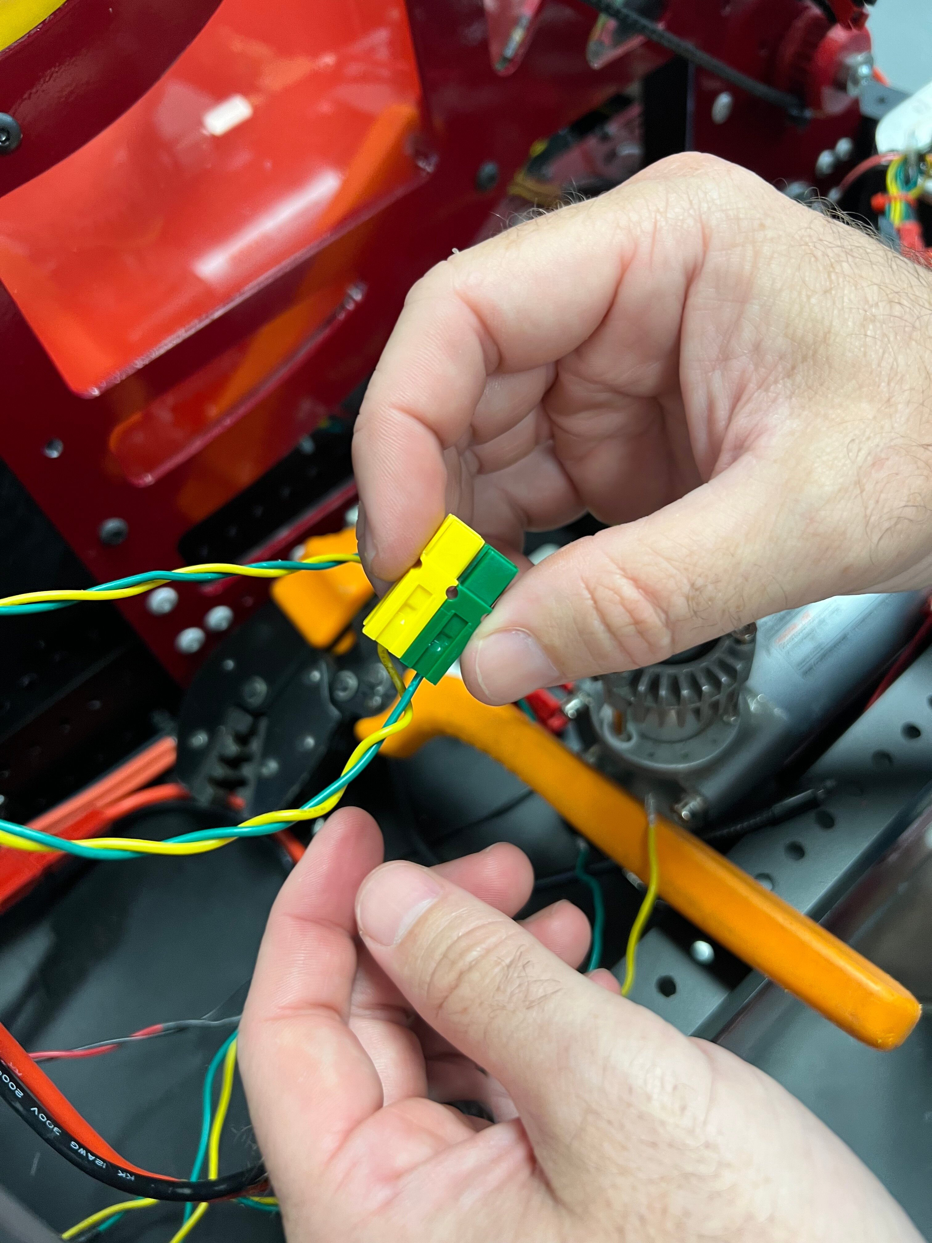

How do you use wagos for CAN? We mainly use 3-pin connectors installed on falcons and other VEX products. Wagos sound like an interesting alternative, do you have any photos of your CAN wires?
We used Andersons for about eight years but began transitioning to these Wago connectors last year. They require no tools and provide a firm connection point that is visible for inspection, and we have had no disconnects through a tough competition. Andersons are very good but are expensive and relatively time consuming. (edit to add: we used Wago connectors for CAN connections for a long time prior; first with the old style model and switching to the clear connectors several years ago, so this was not a cold switch over for us, we already knew and were happy with the product)

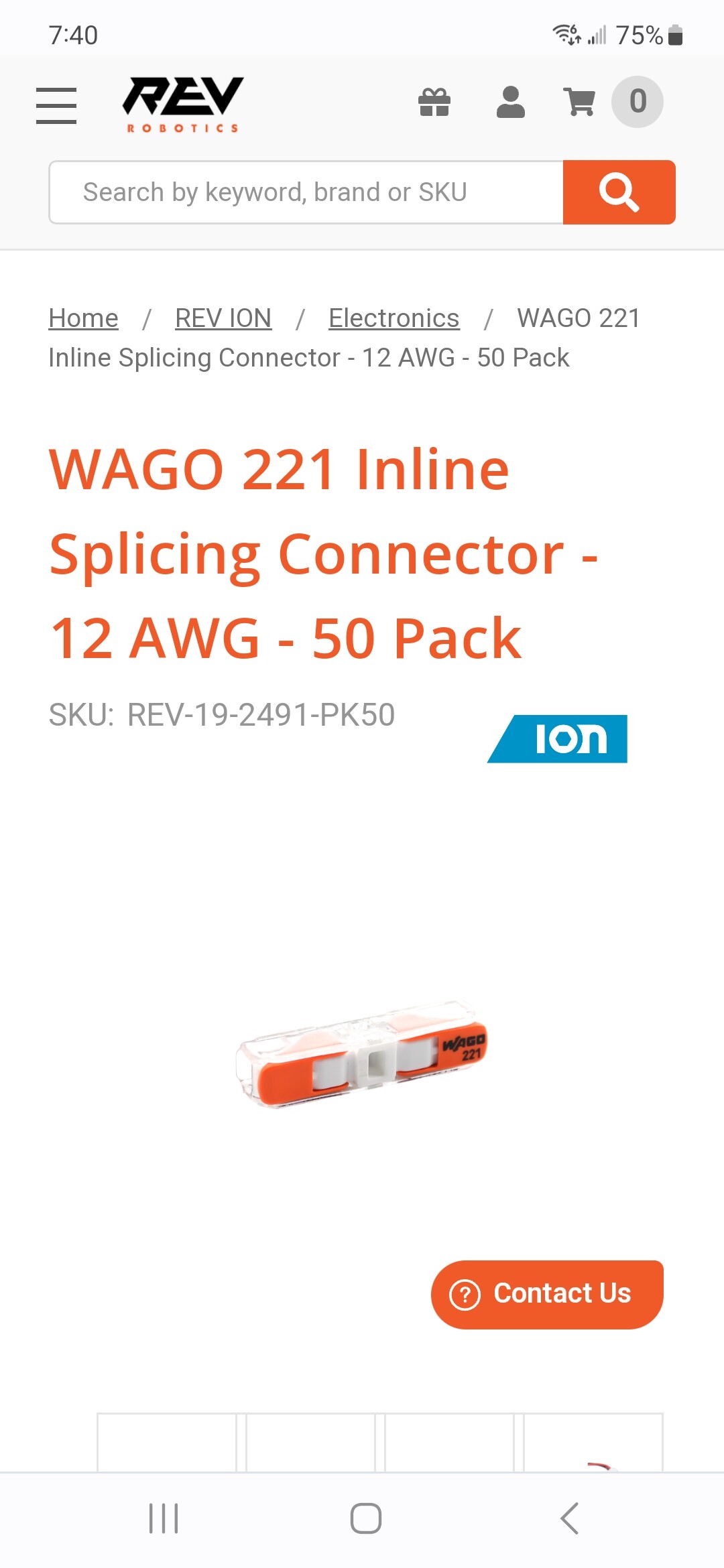

These are significantly cheaper than Anderson connectors which is a plus for us. We haven’t used Wagos on a bot before, do you have any advice for using them the first time? Also does REV sell them in different sizes than 12awg? I looked and will continue to look but haven’t seen anything besides 12awg so far.
Neat thing, you can use these Wagos all the way from 12ga to 22ga and they provide a firm connection. We are using them with both our motor connections and our CAN wires now.
