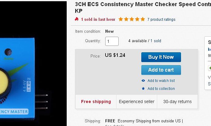

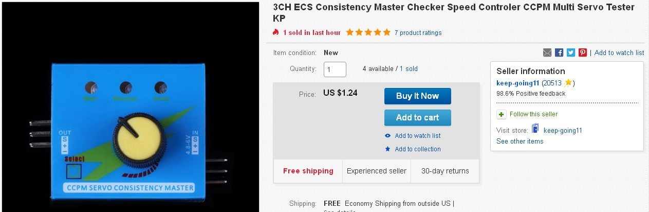

electronics gurus: what is this part?
Like $1.24 with free shipping. I bought 2, from 2 “different” sellers. Will gut them and take pix when they arrive.
