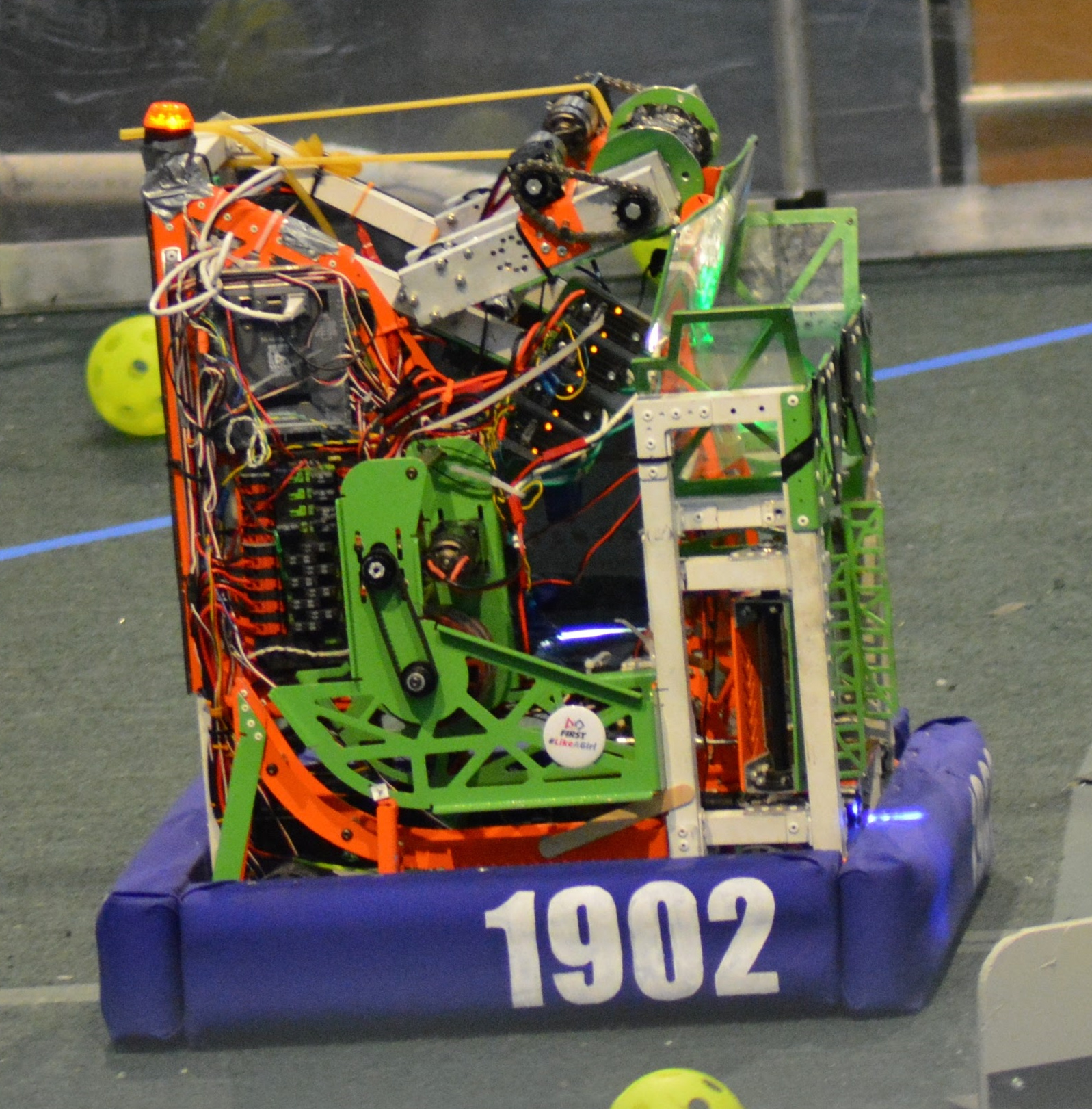

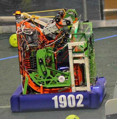

All the time! Here’s an example:
As you can see, RIO and radio on this side; most of the motor controllers are on the other side panel.

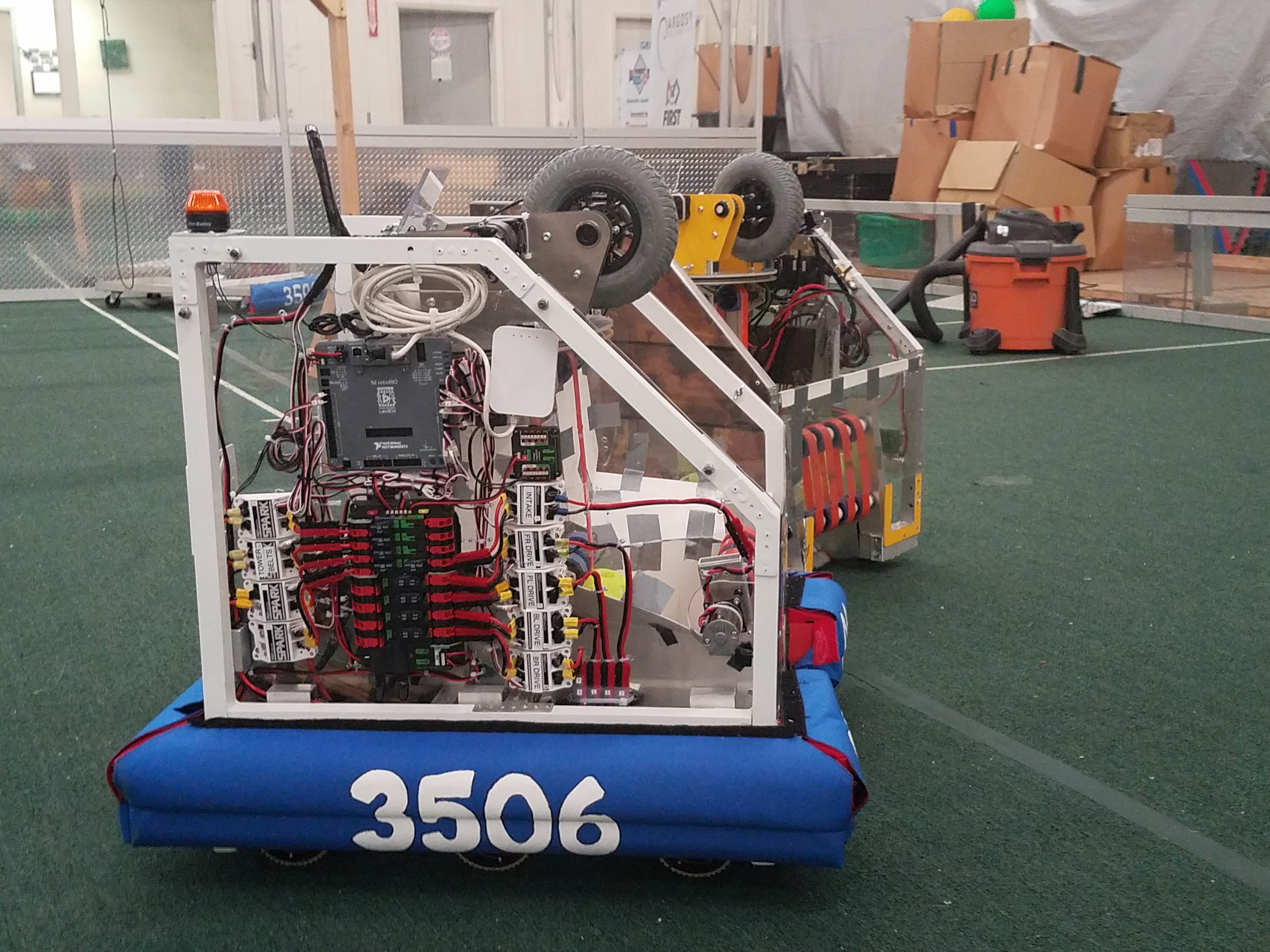

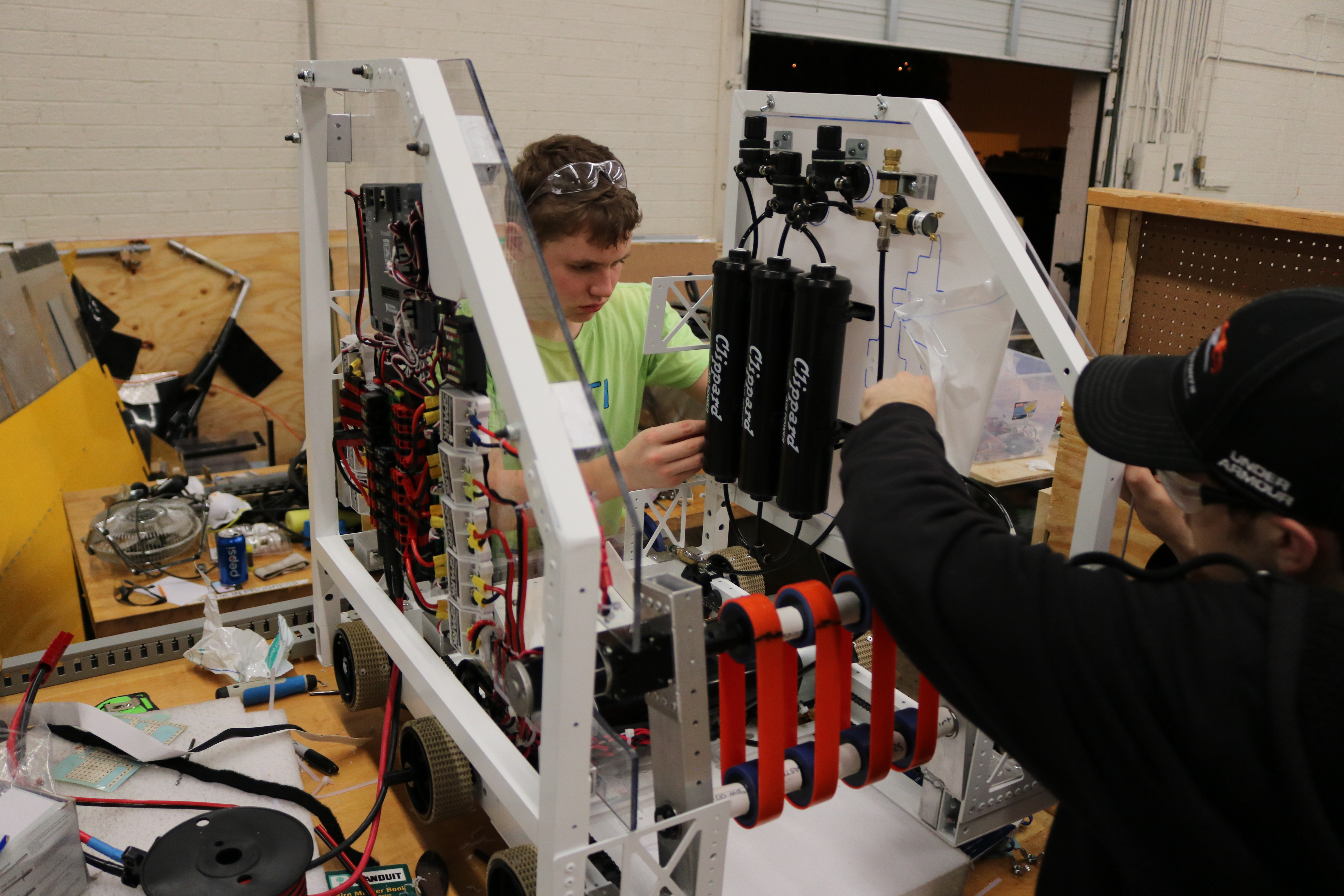

We did this in 2018 and 2017 on both of our robots. Using power pole anderson connectors we were able to remove the boards and any individual components in seconds if we had to. Pics below from 2017 to maybe inspire some ideas

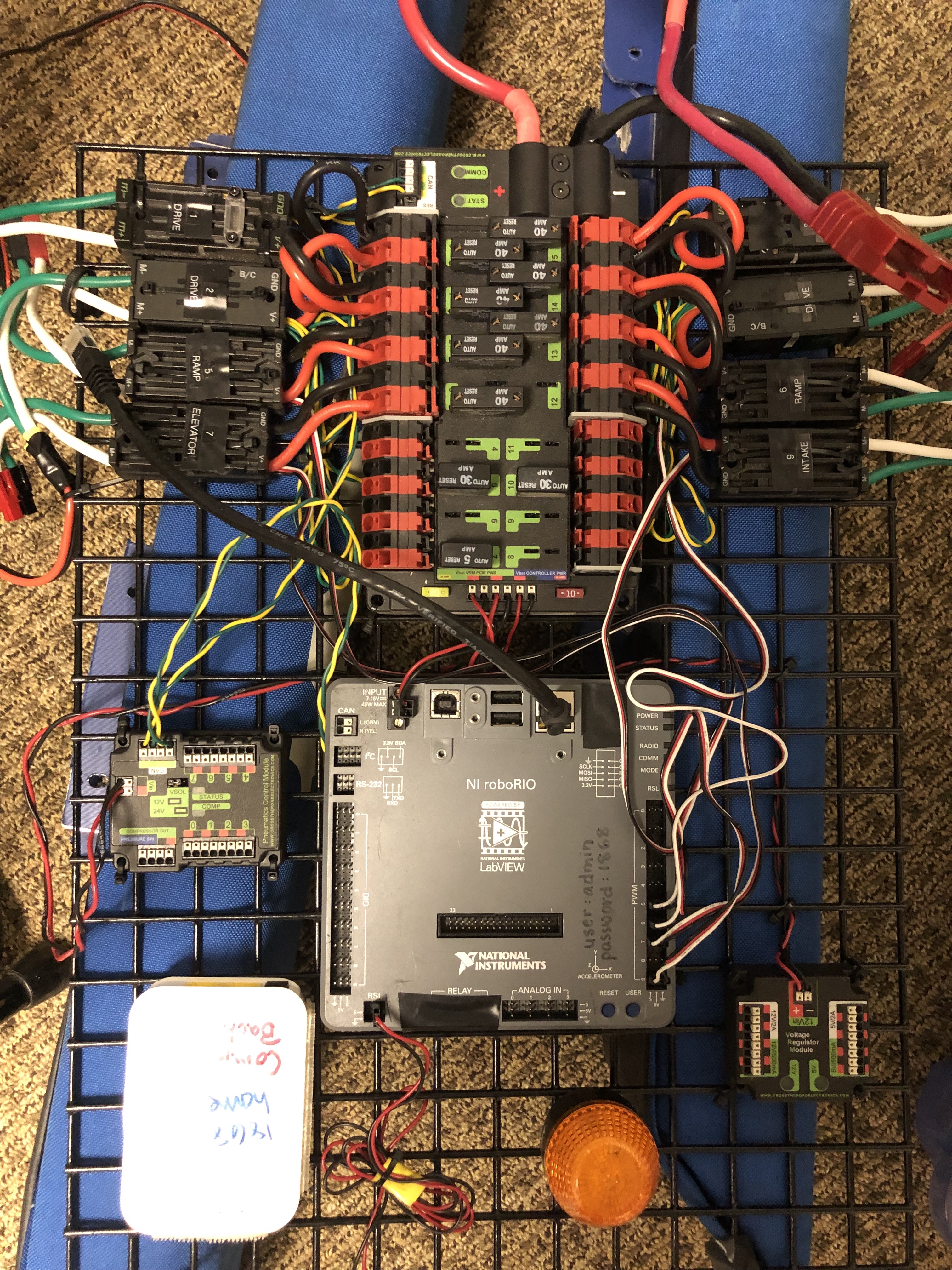

Last year, we didn’t have a lot of space on our robot base so we ziptied most of our electrical components onto a grid. We attached the grid to the 2 struts which supported our elevator and covered the entire grid with a removable polycarb cover. It worked out really well and the electronics were much more accessible.
How did you mount this panel? Zipties?
Zooming into the picture, yeah, everything is mounted with zip ties (although I am curious how they mounted the Rio…).

yes, we used zipties and mounted the grid onto the 2" by 2" struts that were supporting our elevator
On the bottom of most of the electrical components, there are these small gaps in the corners. You can put the small zipties through all of them and mount the components.
