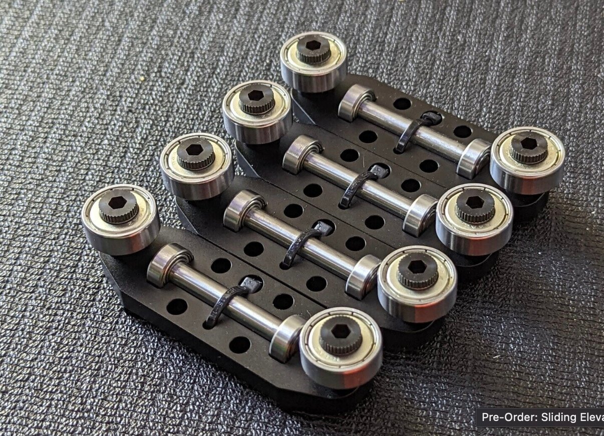

Before the new release of COTS products in the past month by REV, AndyMark, and The Thrifty Bot (TTB), WCP was in my opinion the go-to option for COTS elevator bearing blocks for manipulator-mounted elevators. It may be hard to gauge the performance differences between these new products, since they are all on pre-order, but if you had a choice, which would you say is the superior elevator bearing block kit?
WCP on left, AndyMark middle left, TTB middle right, REV on right
If you were going to use a COTS bearing kit on an elevator, which would you buy?

I was going to include TTB, ut I do not believe they sell the bearing blocks for their Thrifty Elevator as a standalone product (I may be wrong). They have the bearing blocks for their telescoping tube kits, which my team used this past year, and they have their new Thrifty Elevator, but I couldn’t find the bearing blocks for their Thrifty Elevator as a standalone product on the site.
They do indeed sell them separately, see the link I posted.
Was really happy to see WCP come out with the inline bearing blocks that have all .75 OD bearings. I’ve cracked WAY to many .5OD bearings over the years on climbers and elevators we try to avoid them at all costs.

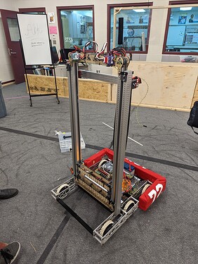

I picked the Rev block since that’s what we’ve been messing with, but if the WCP clamping ones come back in stock we may go that route.
We have experimenting with doing cascade rigging between the tubes, and it’s looking really nice.
Not sure about driving that timing belt yet (although that part is certainly compact) but all the rigging being 2 big timing belts and 2 clamps is really nice over dealing with rope. The Andymark and TTB ones have parts that get in the way of the belts, so for now we will stick with the side-mount style.
