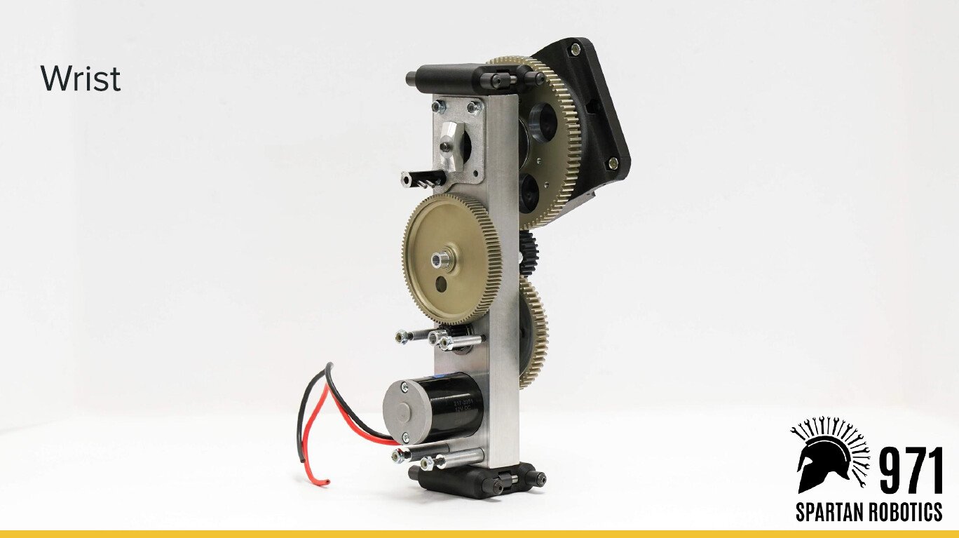

I think one of my favorite examples of a compact elevator carriage with a wrist joint is 971 from 2019. The use of an incredibly skinny sideways elevator enabled them to build the whole carriage from a single piece of 2x1. The tradeoff here being height for width, but in this case I think it led to a much simpler overall design given the size and tight packaging of that robot.
*Image taken from their slide deck about their 2019 robot, page linked here: FRC 971 Workshops Download Form | Spartan Robotics (FRC 971)
